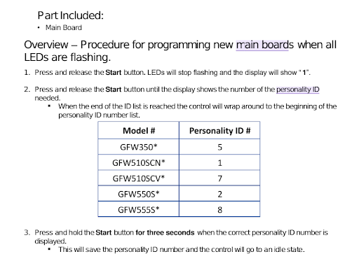

Control panel was dead and changes main control board power back but need to reset board
Brand:GE
Model Number:GFW550SSN1WW
Main Symptom: Replaced main control, restored power but not showing correctly
What happens & when:Reset control panel
Error Code (if any): was flashing 88, but after control panel reset just reading incorrectly

It is showing wrong characters now after I I tried to reset control panel but It initially was flash 88. How do you enter service mode how do you check personality/Model configuration and then exit?
The part number is WH22X38697
Ther service mode steps would be greatly appreciated.

I did not get a configuration code with the new board where can I get the code.
You’ll have to contact where you purchased the board
It was Appliance Parts!
do you have your order #
try using this information I am attaching
Also here!
WH22X38697.pdf (148.4 KB)
Yes that is it. Did it help?
