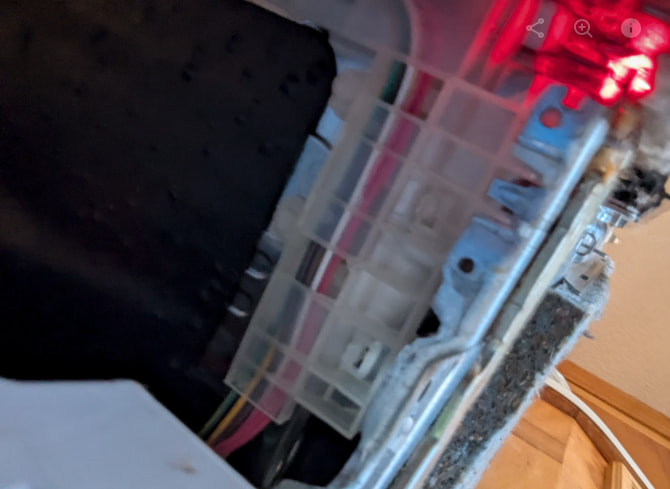

New part arrived earlier today, installed and my optimism was dashed as the beeping resumed within two minutes. I thought maybe just let it run and it will clear. I stepped away for no less than a minute or two, returning to see water coming out of the bottom of the unit.
Coming from right of the machine.
Seemed to be coming out of this area:
I opened the machine, it still had 25 minutes left on the display (did express 30 minute wash).
I did the reset, let it drain and when it was done, there were no error codes. Very confused at this point.
Has the dishwasher been double-checked to make sure it is level? Also, are there any clogged jets or cracks in the lower spray arm that might be causing the leak and potentially the error codes?
I will double-check the machine for being level - thanks for that tip!
I have removed the bottom spray arm a few times, but never inspected carefully for any cracks or damage. I will definitely look at it carefully and let you know. I also ordered a new lower door tub seal - that leak at the front was very concerning.
