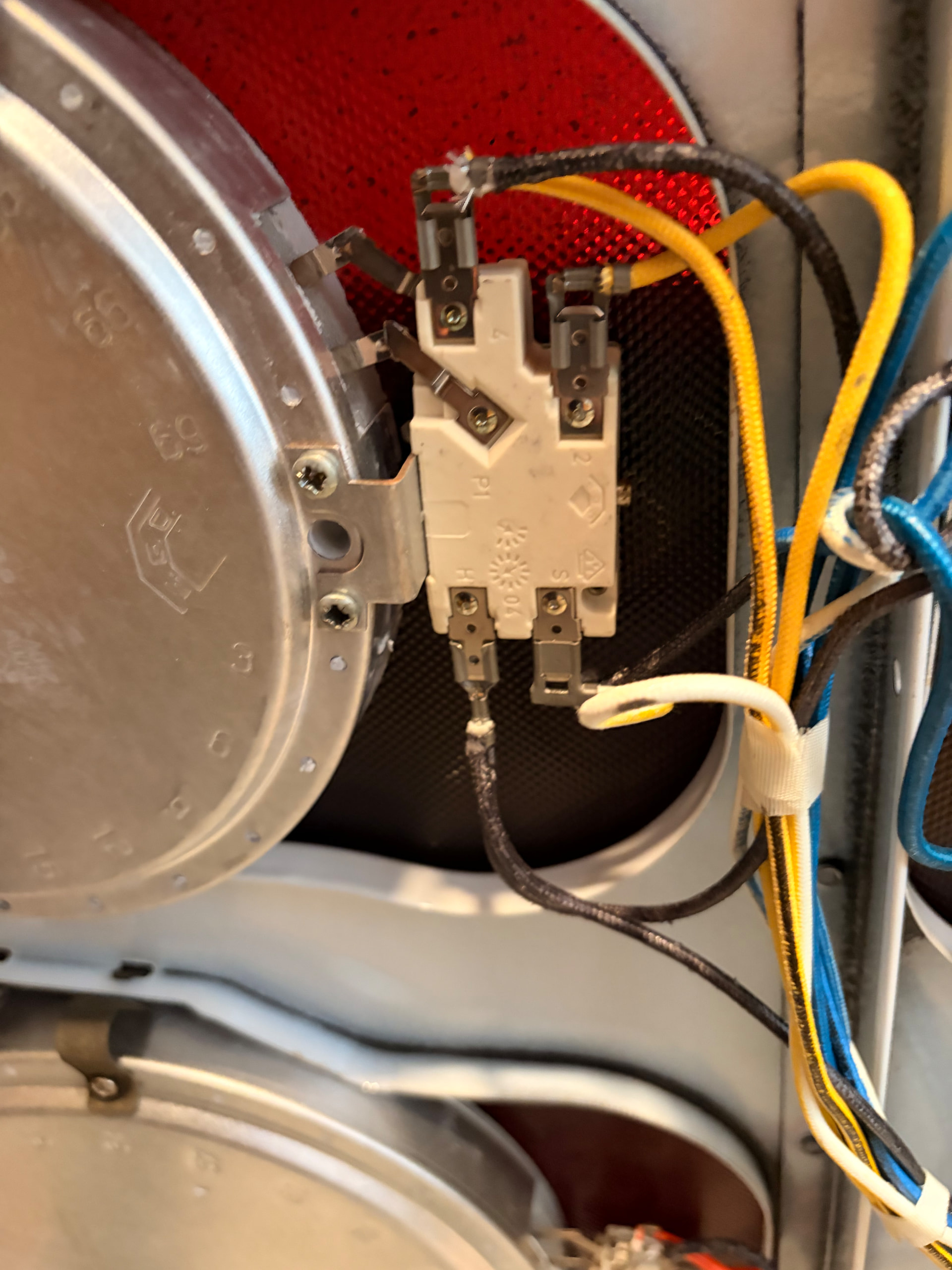

Connections on part does not match
Brand: ge
Model Number: jp69w0h2ww
Main Symptom: connections do not match on part wb30x44826

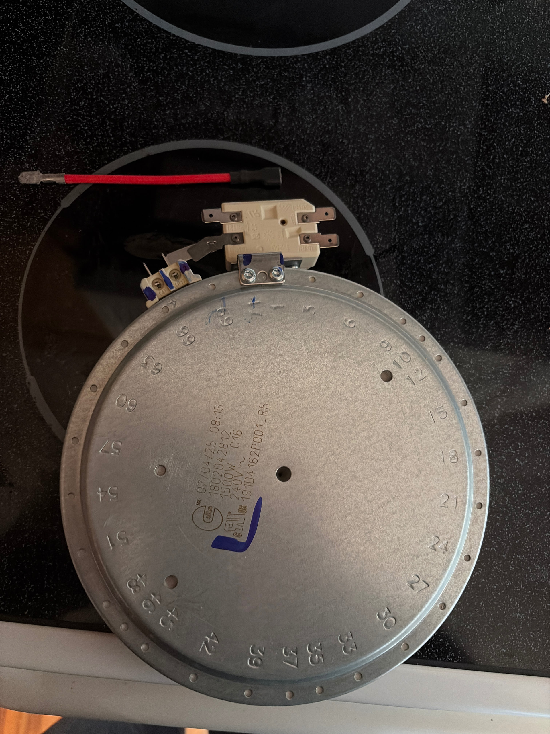

What happens & when: they sent a jumper cable with no instructions on where to hook it up to. I think I know but would prefer to be sure.
See how the new one only has 3 connections and the old has 4. Do I use the jumper to create the 4th connection?if if so it is it the black and yellow black wires that jump over to the non connected element stud?
I’m not really finding that model #, but that jumper should just be incase you need to extend a wire. The hookups will be to the same letters as the original.
