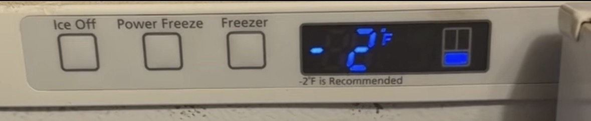

The controls for the ice machine are behind the left side French door. I have poked all around them and cannot get it to cycle the ice machine.
Note: the ice machine is in the pullout freezer.
I definitely think the problem is with the control panel because I tried to shift the wiring harness around as much as possible and could not get it to cycle.
But I don’t see any evidence of humidity or moisture damage to the control panel

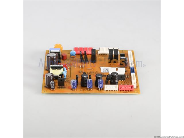

Possibly this ) Samsung DA92-00202A Refrigerator Lcd Display Control Board Assembly | Genuine OEM Part )

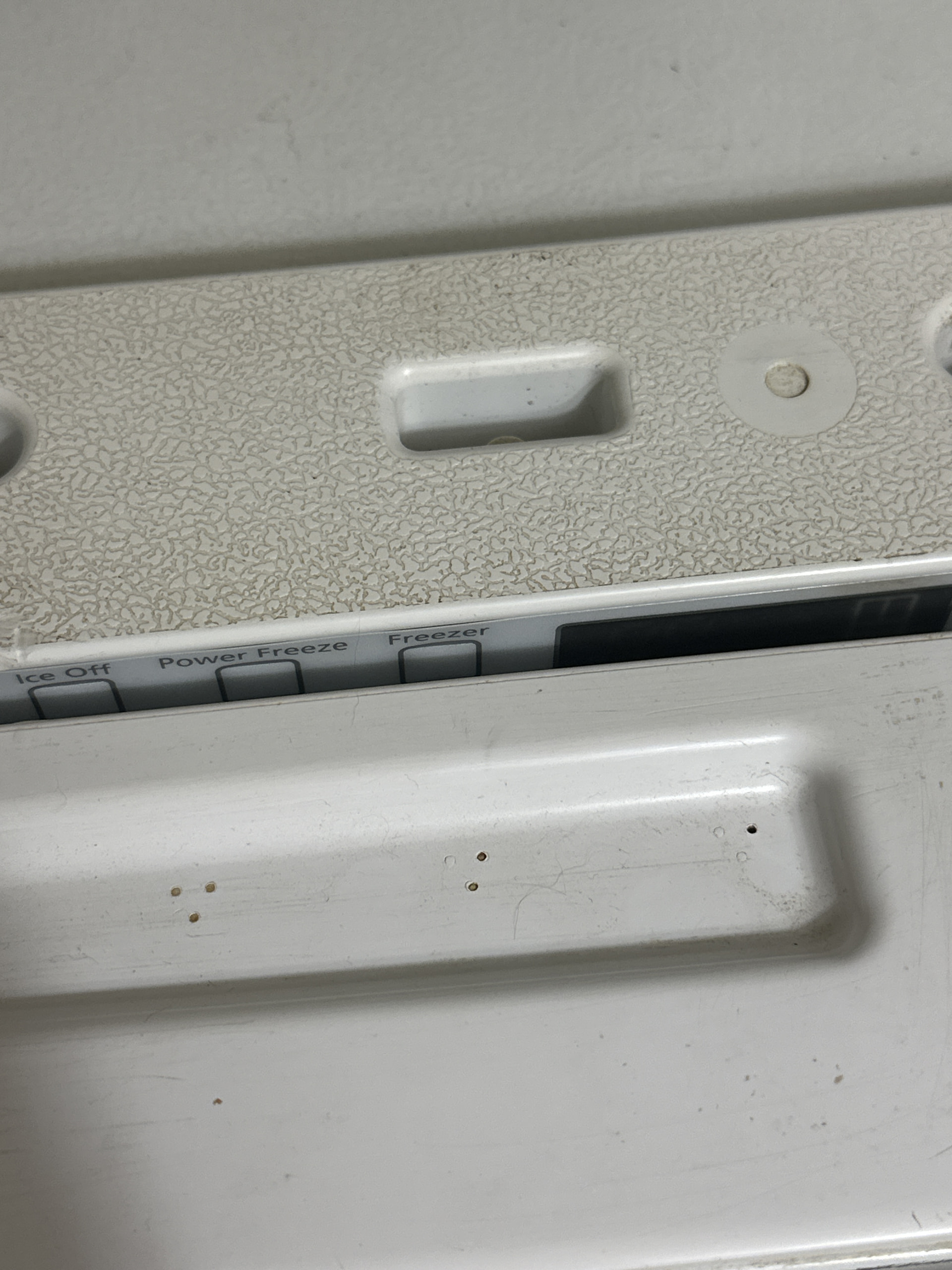

Here’s a photo of what the left side looks like with the door open. If I shut the door, then the lights go off, but I can still see the control panel from the top crack.
The lights are clearly off (signaling that the door is shut) and I can use a spoon to poke the ice off button multiple times, and the ice machine will NOT cycle.
It does so completely randomly. Beating hard on the top control panel doesn’t do anything.
I will give that part a try. Thanks!
It worked. Thanks again!
