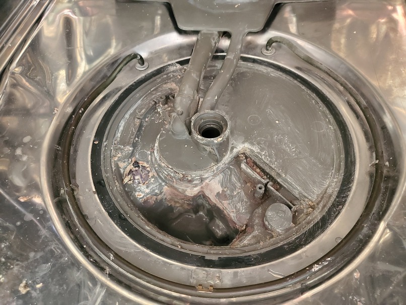

Cleaning kdtm354ess2
Brand:kitchenaid
**Model Number:**kdtm354ess2
Main Symptom:dishes not clean
This dishwasher has a very coarse screen. There doesn’t appear to be any other easily accessible filter. I have some parts removed (spray arm and the coarse screen (called pump filter). Is there anything else to be done other than pulling dishwasher? As you can see we have some gunk buildup.
Hello, yes you have gone about as deep as you can go into the sump area. I would say the motor may be going out if you mare having wash problems. There are no other filters to clean.
