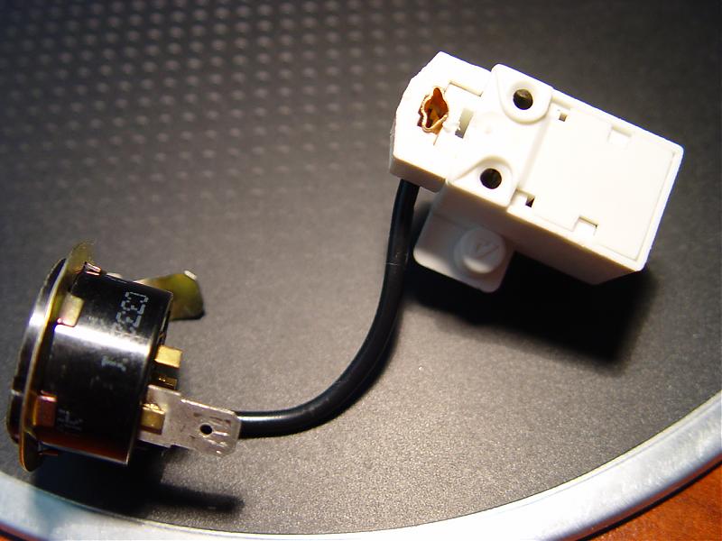

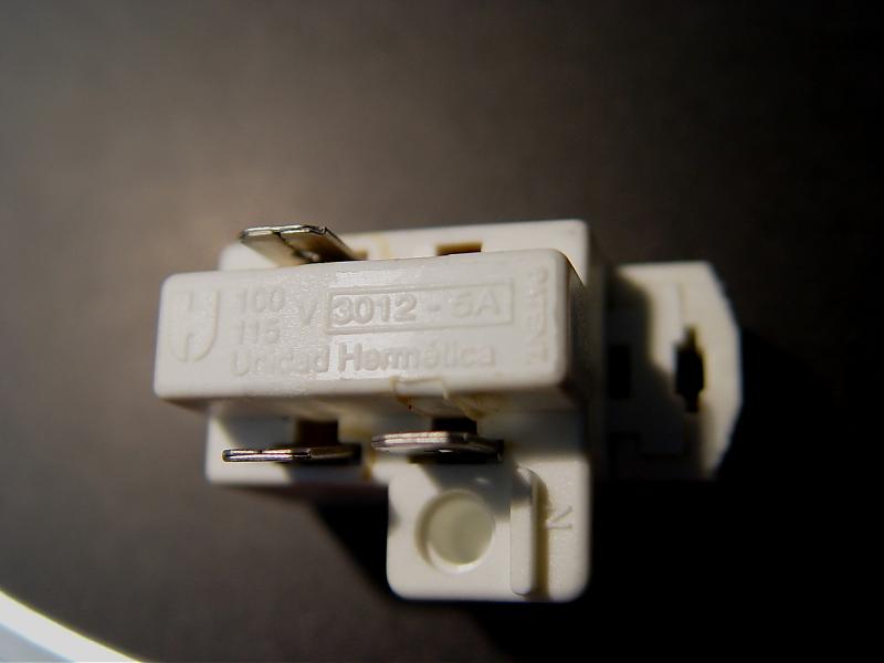

I have done some searching online and have come up dry on finding a replacement part. I have included pictures of the parts in question as well as pics of the compressor.
I realize there may be a chance there is more wrong here than the relay, but I did notice this: The insulating boots on the blue and brown wires that go from the relay to the capacitor where very discolored from heat. This would lead me to believe that the relay has been getting very hot.

That freezer unit was made by Haier, I would recommend using an generic start device part AP3540667 or a 3 n 1 hard start(ommitting the present capacitor) AP3540659.

[COLOR=#333333]Update: I installed the Supco Relay/Overload Protector (not the 3 in 1) and plugged the freezer in. The compressor blew up in my face, and I am now being rushed to the hospital… okay, yes I am kidding. Seriously, the compressor is now making a low buzzing noise that sounds a bit like an electric motor under load trying to turn without success. Sometimes it turns a little faster, and then slows down again. Is the ZEL compressor shot? Or is there something else I should look at. Yes, I know I should just junk the thing since (according to the last post) Hiaer makes, well Junk. I am however willing to pursue fixing this a little longer before I go to sears and plunk down some money on a new freezer. This one was free, and thus far I only have 20 minutes and $16 into it. I view this as a little bit of cheap entertainment, since I pride myself on being able to fix things instead of sending them to the land fill. I am sure some of you out there may view my pursuit as some sort of strange self punishment. In any case, anyone that can offer any help or guidance on this little project of mine would be greatly appreciated.[/COLOR]

If the unit is humming then the compressor itself is shot and whould require replacement. Recommend just taking it the the graveyard, as you so put it.

Relay part #rf-0010-65

Hey all… The freezer is fixed and has been running for about a month now. The solution was to install a 3 in 1 Relay kit (Part# AP3540659). I have two theories of thought regarding this fix.
  1. I was told that refrigeration systems sometimes get overcharged at the factory thus making them harder to start, and that the 3 in 1 Relay/Hard Start kit can overcome this.
  2. The two discolored(over heated) wires were the ones that go to the original capacitor. It may be that the original capacitor was weak/failed, and thus caused the freezer to stop working.
Now although I don’t disagree with Libertyappl about these being a very cheaply made unit, instead of sending it to the appliance graveyard (landfill), I now have a functional freezer for a total investment of $20 in parts. I fully expect that this freezer will not last 5 years, but for now it is doing just fine. Hope this helps.

Since a 3-in-1 is not recommended and the part is not available, I was wondering if there was a part that would be compatible with this freezer. It’s listed as RF-0010-65 in the Kenmore manual and as part#AP3723113 (made by Haier) on the Appliancepartspro website.
We’re just stuck right now as how to proceed. I wouldn’t want to use anything that has even a remote chance of causing a fire. If there is not a compatible part, then I guess it will have to go into the landfill which i just hate to see in a freezer that’s only 5 years old. The switch seems pretty basic and I would think there would be alternatives, but being inexperienced in freezer repair, I just don’t know.
