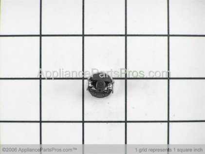

The “heater circuit” in your dishwasher consists of two parts: the heating element and the hi limit thermostat. There is no thermistor in your dishwasher.
I did recommend in the previous reply not to replace any parts before we can perform the troubleshooting. At this time you already have the new heating element and we have to test the hi limit thermostat for continuity.
Your husband should remove the bottom panel and locate the thermostat on the left side. It should be attached to the dishwasher body.
[CENTER]The hi limit thermostat
[/CENTER]
[LEFT]It should be replaced only if it’s open.
If the hi limit thermostat is fine then he has to check all wires involved in this circuit and only if there is nothing wrong - the control board has to be replaced.
About prices: you can buy the control board from Appliance Parts Pros for only $74.78 and the hi limit thermostat for only $11.08.
  • The part number for the control board is AP3775998
  • The part number for the hi limit thermostat is AP3010530
Gene.[/LEFT]
