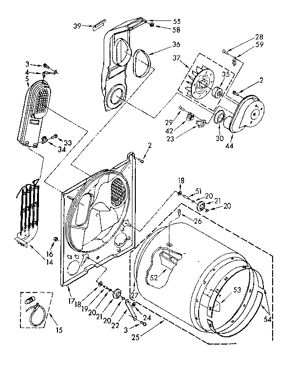

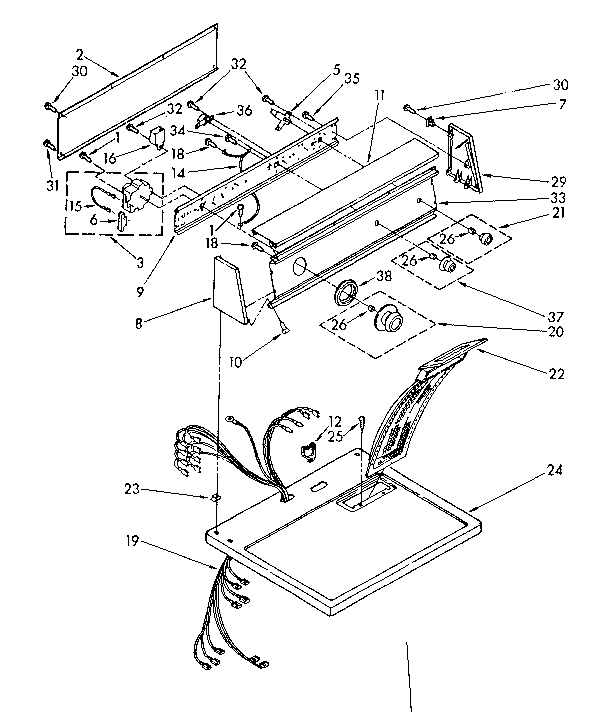

Assuming there is 240 VAC at the dryer wall outlet the problem can be:
A bad thermal fuse (#59 on the diagram),
A bad door switch (#41 on the diagram)
or
A bad timer (#3 on the diagram).
The motor is the last thing to think about, especially because the timer is silent.
All of the above listed parts have to be checked for continuity. You said that all of them are good. I would like to know how did you check them.
The wiring diagram should be inside the control panel, perhaps glued to the rear cover. You’ll need it to check the timer.
