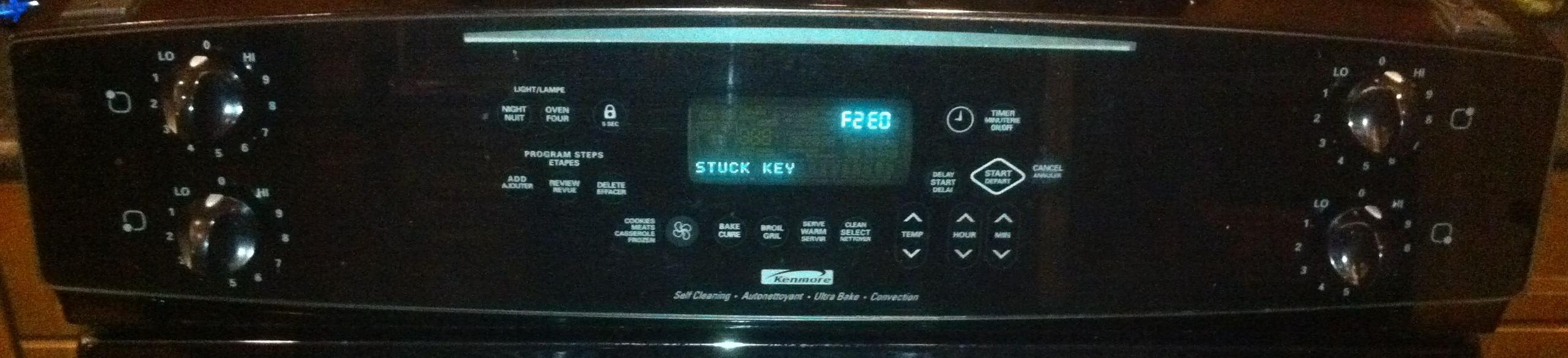

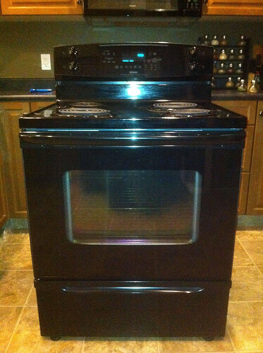

I have a Kenmore range that recently has started displaying the F2-E0 error and have determined that it is likely the control board. I am capable of replacing the board but I have no idea what model my range is so I can buy a replacement board.
I have checked under the removable burners at the top, behind the range, and along the edges where the oven door opens. Any help is appreciated and I have linked to pics to help. Any help is appreciated :slight_smile:
Open the drawer and look along the sides of the frame. Also with the drawer open take a close look up along the very bottom edge of the oven door.
If the sticker is missing.
Unplug the unit and rear cover to see if you can get the manufacture’s/part number off the control board.
Then perhaps it can be cross referenced using this number.
Thanks for all the help, I found a sticker with a mod# 880.598194P4 but can’t seem to match this model number on any parts sites.
Were did you happen to find it?
Is this a U.S.A model or maybe a Canadian model?
I found it on the inner wall on the left hand side after opening the drawer. It is a Canadian model from Sears I believe.
