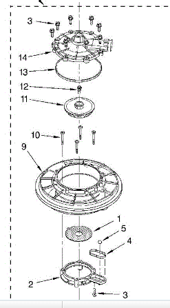

Can this KitchenAid filter be cleaned or do I need a whole new motor?
Good morning!
I am an amateur DIY, and have successfully repaired my Whirlpool washer several times. So…
I looked up various videos on YouTube to see how to clean out my clogged dishwasher. However the motor seems to be much different than everything else out there…
I removed the pump outlet (14) and underneath THAT is the screw for the wash impeller (12) and the impeller disk (11). First of all, I cannot even get that screw off. Even if I did, it seems that this screw goes all the way down into the motor - and then a motor centering tool (31) would be is required?
Am I missing something? Do I need to remove the entire motor to clean it? The only other model specific video I found explains how to replace the motor, not how to clean it.
Thank you very much

What seems to be the major problem with your dishwasher?
The bottom of the dishwasher is filled with dirty water and large particles floating around in it. I can run a cycle but at the end the water is “still there”. How can I clean out whatever junk is underneath that filter/motor?
You may want to check the air gap on top of the sink and the check valve as described in one of our previous posts: http://forum.appliancepartspros.com/dishwasher-repair/4452-whirlpool-dishwasher-not-draining.html

I actually cleaned out the air gap a few weeks ago and removed a lot of grease buildup from the hose that led from the air gap into the garbage disposal.
I found the instructions for getting to the check valve - when I disconnected the drain hose, water came pouring out the check valve and emptied the dishwasher. So I surmised it was not the check valve but a hose obstruction. I used a wet/dry vac to apply suction to the hose and heard something slurp into the bucket, followed by some odor. I then ran a complete cycle and the water drained correctly.
Should I still remove the check valve and check behind for debris? There are still little chunks and flakes on the walls etc.

It would not hurt if you will check the condition of the check valve.
