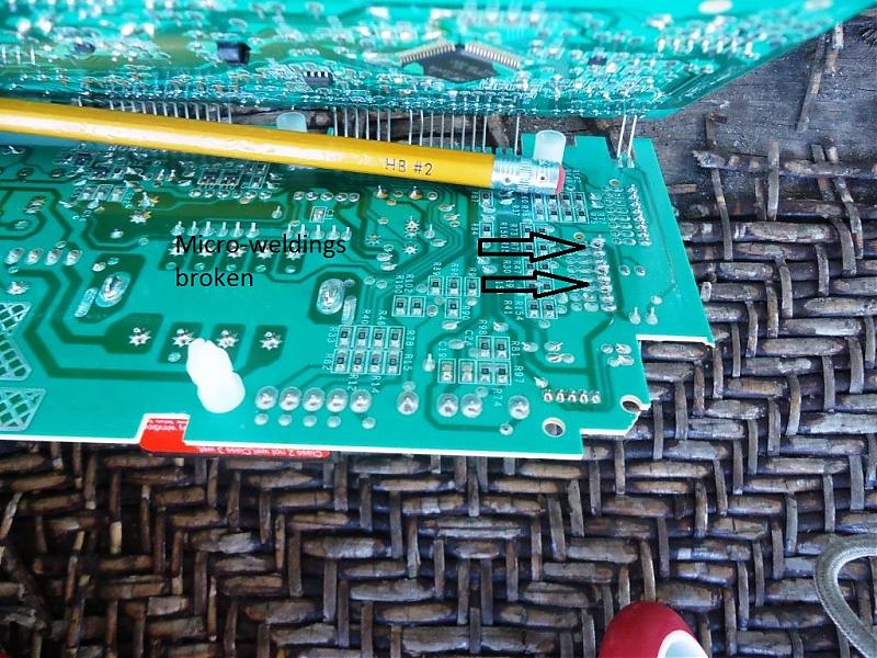

Oven Electronic control board AP5653775 broke a connector pins micro-welding while I was connecting the switch membrane flex and pushing too hard. I wonder if it can be repaired?.
Please see attached pictures or visit: https://www.dropbox.com/sh/iid036ixlfzj8cu/AACoC2uGzsD0dn7HTIZTVSq7a?dl=0
Probably yes though I cannot really see what is bad.
You will need a magnifying glass.
I use one that mounts to a table and has a built in light.
Also a soldering iron that has a very small tip and low heat.
You have to have a lot of experience soldering since overheating and ruining a board is very very easy with micro circuits.
If you take it to someplace local then make sure that they have experience with these types of repairs.
