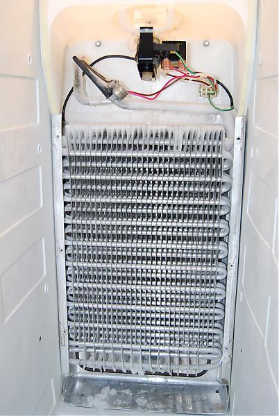

Ok so after running for many hours, it went back into it’s failure mode and yes, the evap fan had stopped running and so had the compressor, and if we sat there and waited, I could hear it cycling, trying to turn on and failing, and it’s probably been stuck like that for 10 hours.
So I pulled the freezer plate and bumped the fan to get it running, and the coils after it had stopped running for hours looked like this. (attached.) BTW, what’s the sensor at the end of the evaporator run for?

[COLOR=“DarkRed”]So I pulled the freezer plate and bumped the fan to get it running, and the coils after it had stopped running for hours looked like this. (attached.) BTW, what’s the sensor at the end of the evaporator run for[/COLOR]?
Hard to use the coils for diagnosis as the unit was off for a long time.
Did the fan start up as soon as you bumped it?
And was the compressor trying to start?
The sensor is a defrost thermostat.
A defrost cycle is started on a set time basis and has a set duration time, usually about 30 minutes. But lets say that all the frost/ice is melted off the coils in 15 minutes then the defrost thermostat opens killing power to the heater so that unnecessary extra heat is not introduced into the freezer.
The thermostat opens just above freezing.
As a test of the evap theory, I grabbed the hair dryer and hit the coils, figuring in a few minutes if that was it it might unfreeze. Was surprised that the compressor started up in -30 seconds- of the hair dryer hitting the evaporator. So I turned it up to max, sealed it up, and it’s been running for hours again. I don’t get it.
I also do not understand this.
Could be that it was just a coincidence and the unit came out of a defrost cycle.

Yes, the compressor was trying to start at the time. And yes, the fan starts with a bump. Motor’s worn and so has a high startup friction but runs once it’s moving.
