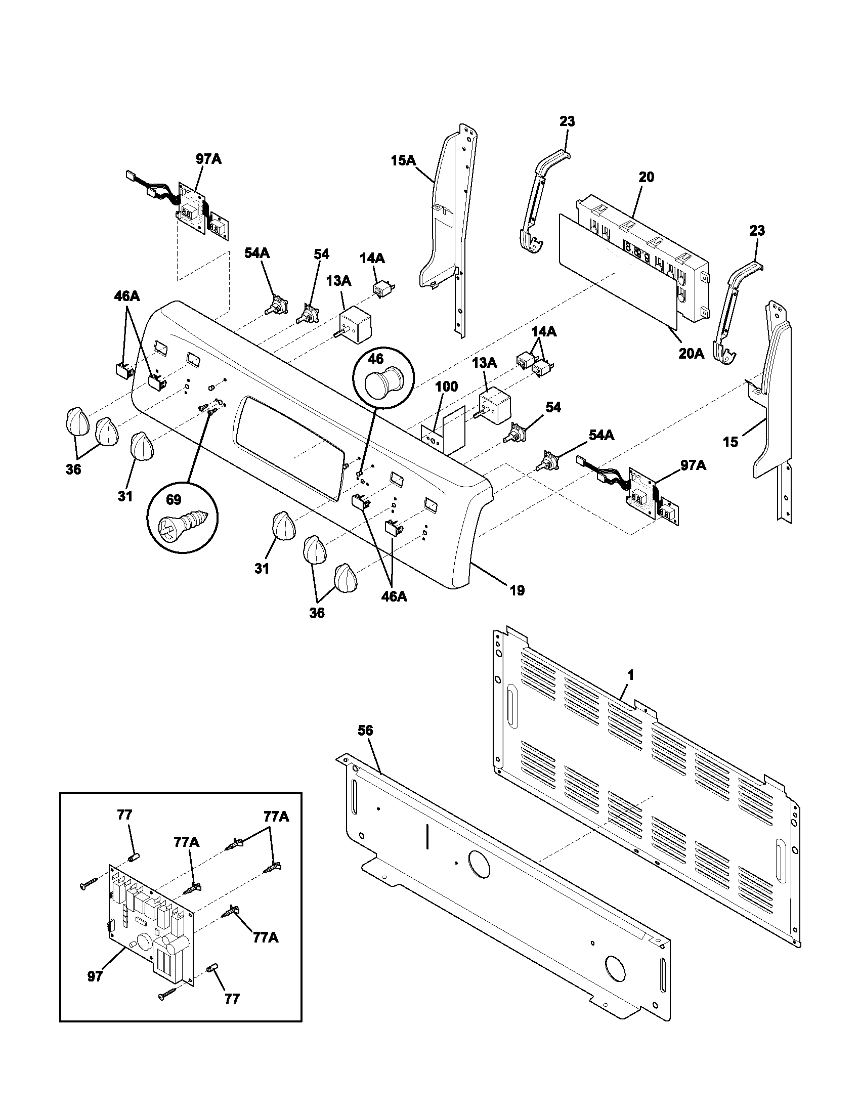

Hey Gene, thanks for your response, and hopefully, you can help. When we use the front right burner, its staying off after turning the knob to the off position. It displays “HE” at the knob, i’m assuming its because it is still hot. We have to secure the stove at the breaker. Then when we turn the breaker back on, the eye is still on. This has happened before in the past but eventually it went off. It’s been 2 days now and its still on. Any suggestions?
Looks like the problem is a bad relay on the power board (#97 on the diagram). It’s located behind the back cover.
I’m having same problem with my Frigidaire Electrolux PLEF398CCB. The small element of the large burner in front stays on. How confident are we that part:
Part Details - FRIGIDAIRE CONTROL-ELECTRICAL, part number: AP4499660
will fix the problem?
Very likely that this is the right fix.
