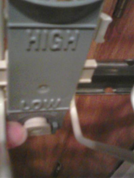

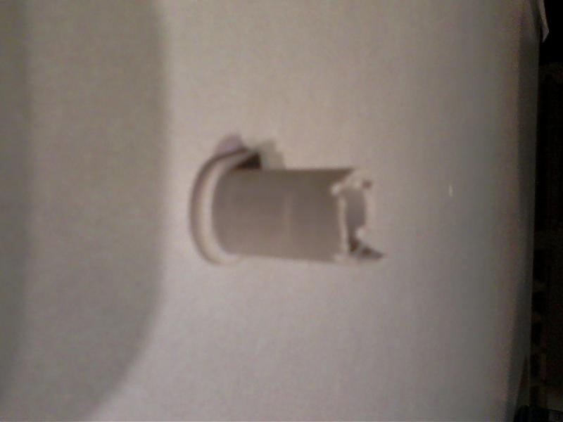

We would like to repair rather than replace the top rack of our dishwasher if there is a part available. The small piece at the bottom of the adjustable tab on the rack that fits into the wheel on the track is broken. I have attached a picture of the broken part and where it should fit on the rack. Thanks in advance for any help offered.
Is that the hub on the wheel that is broken? The second photo looks like it. If so, I found a place that make replacement wheels and wheel hubs for the upper rack on the Maytag as wheel as other brand dishwashers.

This looks very promising! Thanks for the link!!
