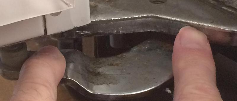

No, thank you for replying. Without your assistance I probably would have spent more money than necessary. I will try the things you said but just noticed something that MIGHT be relevant. As I was opening and closing the freezer door I sensed and heard a grating sound, metal on metal. I’ve identified where that grating is…the lower hinge, attached to the base of the freezer door.
It occurred to me that PERHAPS the door is not closing properly because of tension/resistance between those two pieces of metal. Put another way PERHAPS the door won’t close properly because those two pieces of metal are not sliding one under the other but are colliding with each other.
So before I did anything else I thought to upload some applicable photos and get your thoughts. Wisdom dictates that I shouldn’t try and mess with those screws/hinge until I hear from the pros!
Thanks again
metal on left rubbing on upper right piece.jpg (25.4 KB)
door closed pointing to parts rubbing.jpg (38.7 KB)
Well I went out on a limb and loosened the screw so the two metal pieces don’t rub against each other anymore. Regrettably the door still sticks out compared to the fridge door.

Can you actually push door shut to normal position or does it just stop there?
The door frames (mullions) are part of the hot gas or Yoder loop. There is a loop of steel tubing around each door opening. This helps keep seal area mold free and also helps cool the hot compressed refrigerant in conjunction with the condenser to ensure it enters the evaporator as a liquid. Essentially nine system removes heat from the interior by expanding the liquid in the freezer. It boils off (phase changes) at about -15deg F if I recall my physics correctly.. So short answer is you want the mullions warm at least..
There’s many reasons a door might not shut, from physical blockage to break down of the spacers and cups at the hinges. Its a tough one to diagnose remotely. Look at the parts diagram of top and bottom hinges and see if any plastic spacers may have worn away, I’d expect that to be affecting hinge side but its a possibility that should be checked out.
PNWDrew, first and foremost thank you so much for having replied so many times prior and my apologies once again for a delayed reply. SO rude of me. The reason is as follows. In answer to your question, yes, I can push the door in so there’s no obstacle inhibiting that. I don’t see any distortion in the freezer door to suggest it’s out of shape and I’m confident the new gasket is installed correctly. As you said, without looking at it, it’s hard to properly diagnose…now if you live in Southern California I’d invite you over and pay for your services happily!
So my delay was that I decided to think outside the box and install a thin piece of weather stripping on the outside of the gasket in the bottom corner of the door, the part that protrudes. I lose the magnetic connection of course but it closes that thin air gap which I think was my problem. I’ve since been monitoring the temperature. Happily its been staying around -1, 0 and 1 when the door is closed AND YET open the freezer door for say ten seconds and the temperature later rises considerably, up to 7 at the moment. IT’ll work itself down I think to 0 again but disconcerting. Would you say that’s normal? One of the things I never noticed before!
