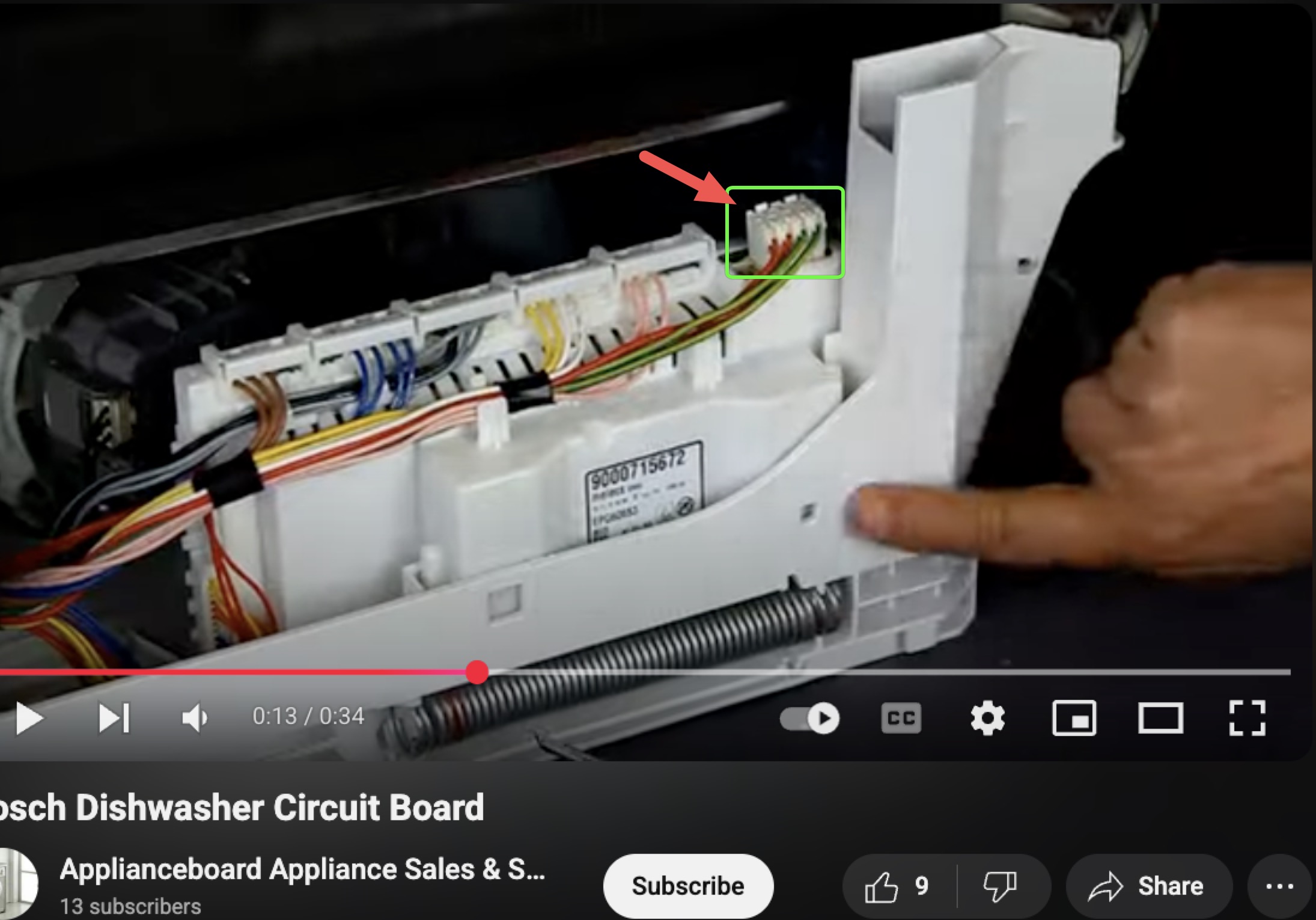

The error E20 is going to indicate an issue within the heat pump circuit, which could be the circulation pump, wire harness, or the power control module. If you turn off the power supply to the dishwasher and access the 4-wire connector on the top corner of the power control module, the heater can be tested for resistance. The two red wires and the green wire directly next to the red wires would be tested for resistance to each other and should measure around 15 Ohms. If the resistance is not around 15 Ohms and there is not a damaged wire, the circulation pump would need to be replaced. If the resistance is around 15 Ohms each time, the power module would be the likely cause. Usually, the issue is the circulation pump though. https://www.appliancepartspros.com/bosch-heat-pump-12008381-ap5984938.html
Thanks for the quick and detailed reply. I am an IT professional and not afraid to tinker with personal computer equipment but certainly not very experienced with large appliances. I had gone as far as removing the front bottom cover of the Dishwasher. Am I required to remove the Dishwasher from the cabinet to perform the testing you suggested? If you have further guidance such as pictures, videos or diagrams of the components/cables where to set the multimeter probes, that would be very helpful. Otherwise I’ll search the Internet and if/when I find additional relevant information, I will post it here for the benefit of the board members.
Is it this one below?
That is the exact connector for testing and the dishwasher would need to be pulled out just enough to access this control connection. The power supply to the dishwasher will need to be turned off and the wire connector removed from the control. The wires on the connector would be tested. From left to right, the wires can be considered red 1, red 2, green 3, green 4. A multimeter would need to be set to Ohms or the omega symbol (upside-down horseshoe). The specific setting would depend on the meter as some are autoranging while others have different operational resistance settings. The probes would then be placed in this manner: 1-2, 1-3, 2-3. Are the resistance readings around 15 Ohms?

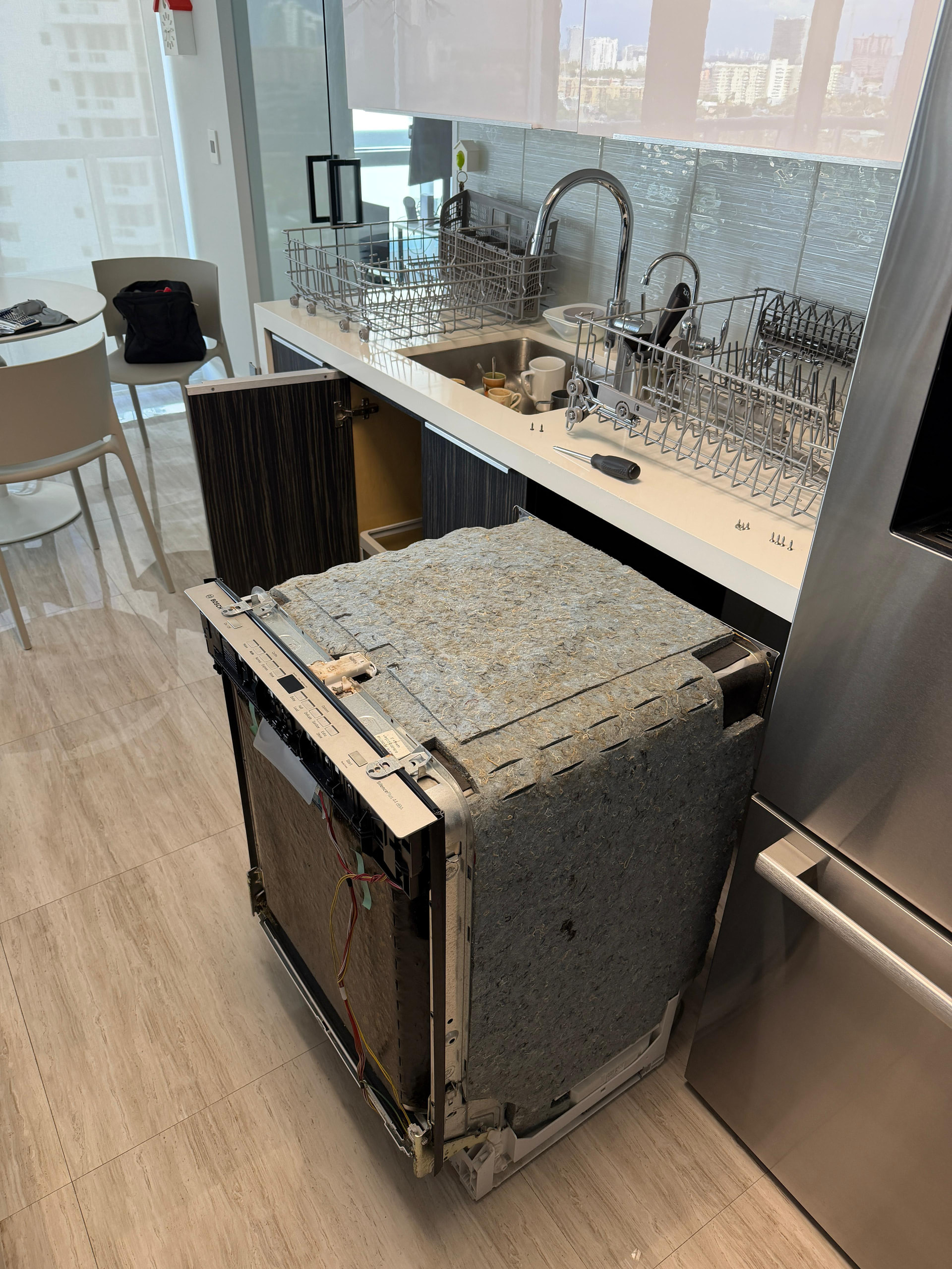

Hi @WilliamM_APP_Team!
The power module in my washer is not exactly the same model as the one I shared before but the wiring appears to be the same. This is a picture of my actual power module:
I was finally able to test the resistance based on the connectors I removed from the board. Here are the readings:
1-2: 10 Ohms
1-3: 0 Ohms
2-3: 0 Ohms

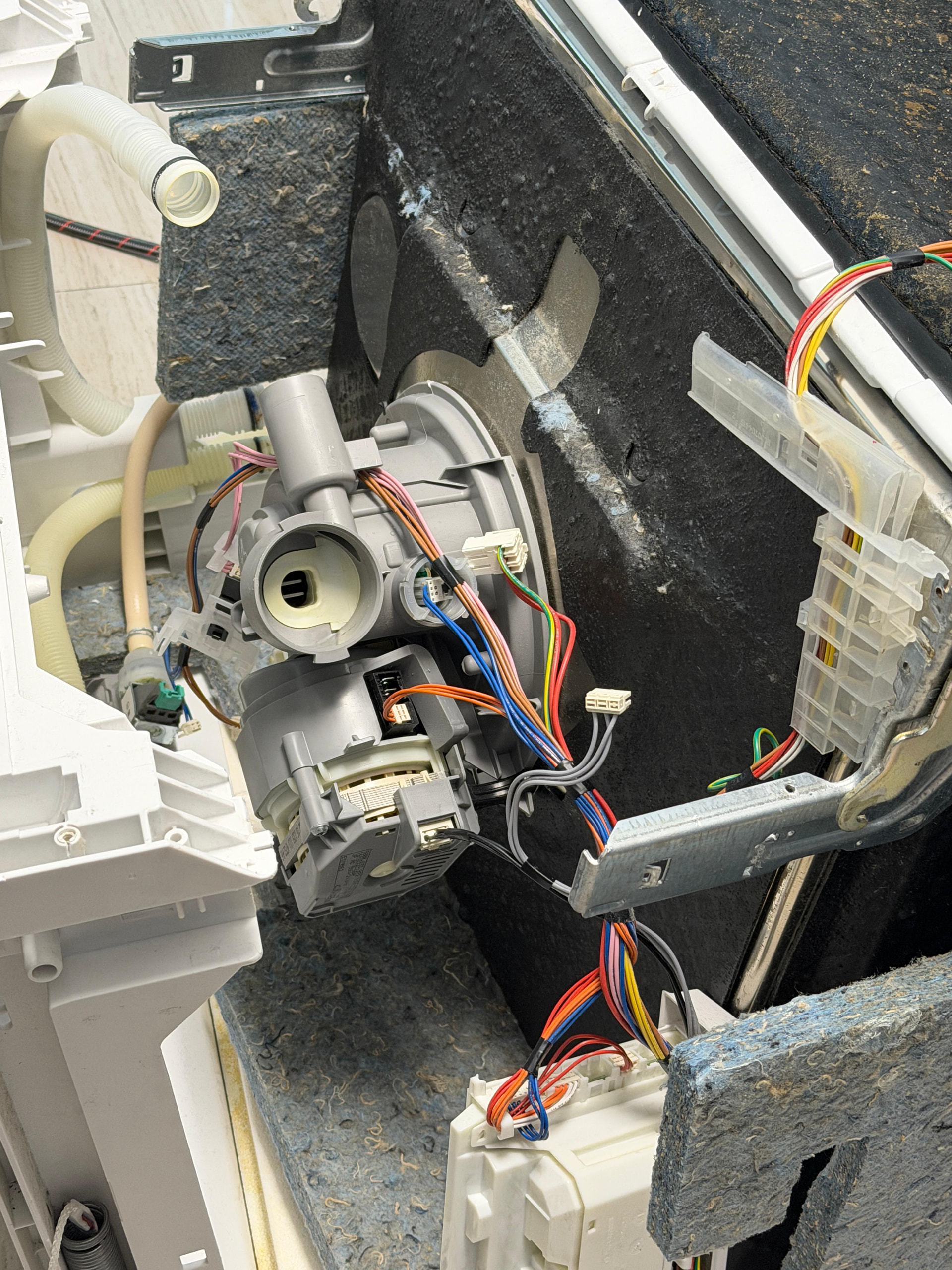

I also wanted to discard a harness/cabling issue so I went ahead and disconnected the harness from the pump and measured from top to bottom following the same numbering scheme and with the same results as above so I think we can safely conclude the issue is a faulty circulation pump that needs to be replaced. I just ordered the part you recommended.
My dishwasher has a bottom plastic cover so its not the same one shown in the video below:
However, I saw another of video where the bottom is removed. Is it really necessary and/or recommended to remove it to install this part? I saw conflicting information in the comments so I’d like to know your opinion:

If there is a whole home protector being installed, I would only use what is absolutely necessary by code as far as an outlet goes. Usually, having an appliance on multiple surge protectors can effect the appliance. As far as installing the heat pump, I have found it to be much easier to remove the base panel so that there is as much working room as possible.

I followed the detailed video from @appliancepartsprosappliancepartspros. My Bosch Dishwasher showed an E20 code and when I tried to start it, it would make 2 faint clicks and stop. After installing the new circulation motor it now works.
However, if I try to run a Sanitize cycle, it does throw the E20 error. This is confusing. I ran with success a complete normal cycle and a Service Mode P1 Cycle, the Dishwasher performed normally.
We’ve been using the Dishwasher a few more times with success so I am considering the issue as resolved. However… someone posted in the youtube channel that an un-properly seated black wire connector to the pump could cause an E20. What are the things I need to further review beyond that wire/connector? Is it possible that I also need to replace the controller board? Is there a specific test to check the controller board?
