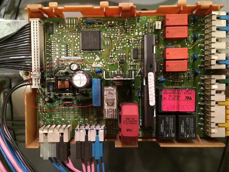

Same symptons, found components on Power Control Module were burnt out..- heavily carbonized and PCB scorched.
Have a new Board ready to install but am reluctant to do so for fear of burning out new $300+ Board. Could worn Motor Brushes Cause this ?
Am attaching board picture with scorched area highlighted.
Cautious about using Motor tests as posted, as I fear that energizing the motor or attempting to do so may play havoc with the new board, but need new board installed to energise.. Catch 22 ?
