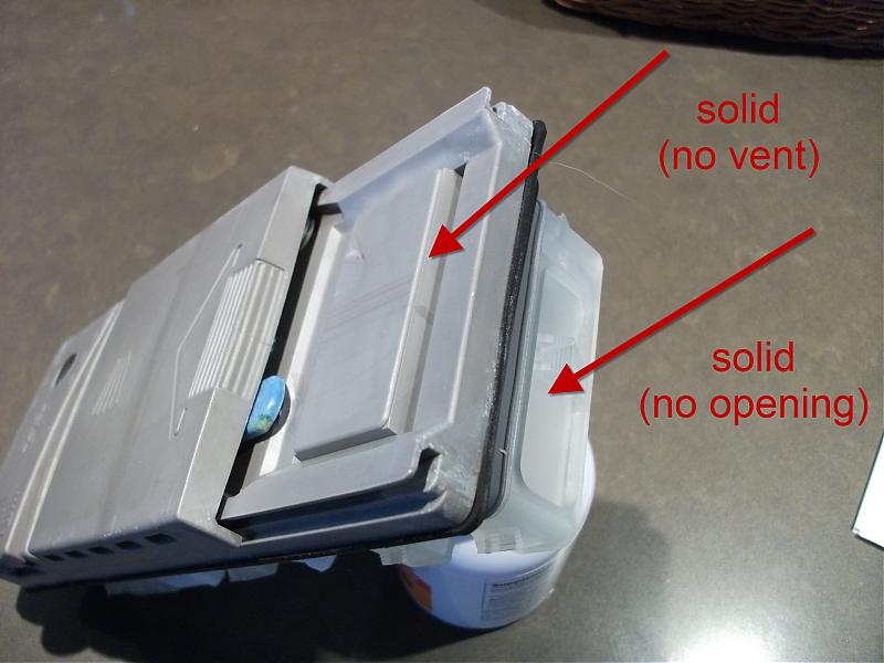

I bought both the vented dispenser called out on the SHU9915UC/11 part list and the not vented dispenser for the SHU9915UC/12. My model is the SHU9915UC/U11 unit and it has the vent on the right hand side of the tank but two different online parts store representatives insisted that this model requires the vented dispenser. The photos posted by the parts stores do not show the difference between the vented and not vented vesions.
After inspecting both dispensers, I can say conclusively that the SHU9915UC/U11 uses the not vented dispenser. I’ll be returning the vented one for a refund.
Its actuall very easy to tell them apart, and you don’t have to take the door apart to do it. You just have to know what to look for. The photos below show the difference.
Pat
Dispenser vented.jpg (48.4 KB)
Dispenser not vented.jpg (49.5 KB)

Check out one of the earlier replies, and there is a picture attached of the vented and unvented dispensers. They are not interchangeable ( at least , not if you want it to work right, although it will probably fit). There is confusion about whether the models came with vented/unvented, and it is quite clear that some models defy the wisdom of what is supposed to be installed. Mine was supposed to be unvented, and it was not. I think others have had the same experience. Just look at the pictures, they are very clear, and you will see quickly which one is right for you.

I realize this is a very old thread, but I am having the same issue with the soap dispenser. Bosch tells me I need AP2802340. But when I received it the short side to the right of the soap area is completely open. My original is sealed. My unit seems to have the venting in the side of the tank. There seem to be two parts that are sealed: 490467 and 488964. What is the difference between them other than double the price? Can I use either one? My dishwasher is [MODEL]SHU9915UC/U11 FD8005[/MODEL]. And my original dispenser doesn’t look like either of the pictures posted previously by paparola1. It has vents, but is sealed. Can anyone tell me which part will work? So far Bosch has not been helpful.
The correct part number for the detergent dispenser for your dishwasher is 490467
It is not vented and supposes to work with your model.
Thanks, Gene. Interesting because the match tool on the site says it doesn’t work with my model. I still wonder what is the difference between 490467 and 488964?
You can find this information in the file attached to the first page of this thread. Open it and go to the second page.There are couple Hints on the bottom.
