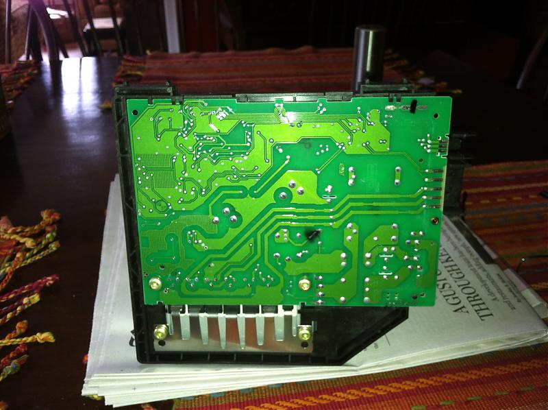

So I have the same problem with the Nexxt Series 100 washer. Unfortunately the motor doesn’t have any brushes to replace in the USA or Canada. I have found that the controller board (located in the black plastic housing to the left of the motor) has a burnt out trace. This either means the board failed “normally” or the motor failed then caused the board to fail :mad: .
motor board.jpg (74.7 KB)

[COLOR=#333333]If you look within the motor area (and all around the base of the unit) you may see carbon dust. If so, the brushes have worn out and it’s time to replace the motor, because, as previously mentioned, the brushes are not available separately. [/COLOR]
[COLOR=#333333] [/COLOR]
[COLOR=#333333]If you’re able to disconnect/reconnect the motor to get it to work for a few days, you’re “cleaning” the contacts on the motor and/or in the harness. I’ve found that the carbon dust corrupts the connection, which results in the motor control board not “seeing” the motors speed sensor (pins 4-5).[/COLOR]
[COLOR=#333333]Again, the fix is a new motor. Occasionally, the motor control board can fail, but it’s far less common. [/COLOR]
