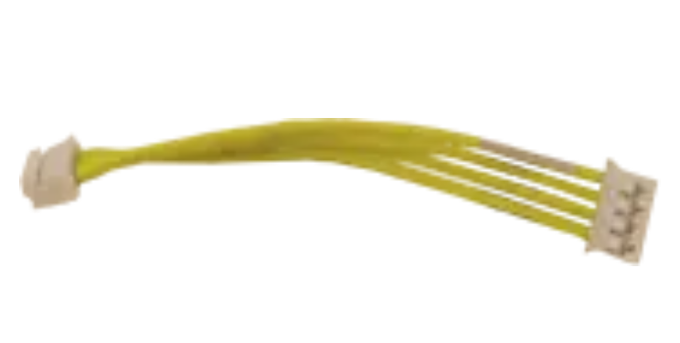

**Main Symptom:**E005 communication error
**What happens & when oven won’t work
Error Code (if any):E005
Parts or tests already tried:11005328
From panel was changed and technician broke the 4 wire cable connecting
the front control panel to main control panel and I need to get the cable . No help from Bosch 26 month old $6000 wall oven can anyone tell me the part number to order this canle
The only yellow wired 4-wire harness I am finding to be like the one in the picture is part number 12029900 in the following link. The only image I am able to find to verify what it looks like is attached. 12029900 12029900 | Genuine Bosch OEM In Stock
Thank you I appreciate it
