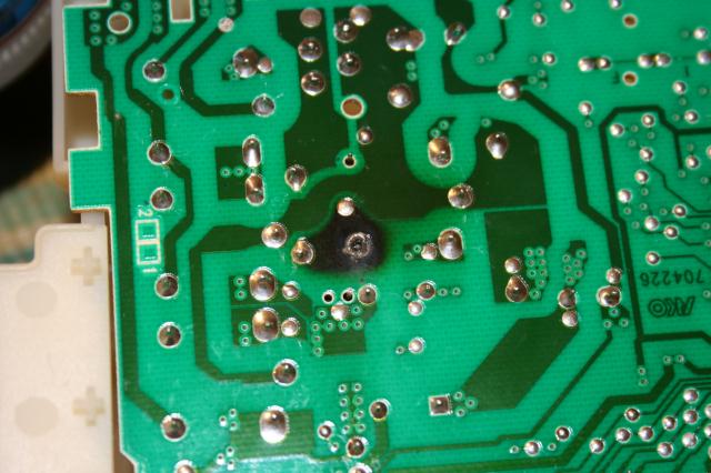

I took the door off and looked at the circut panel.
The bad spot was very visable.(see photo attached)
5 minute solder job and the DW is running as good as new.
Thanks for the advice.
For any other viewers, simple project. Probably saved $100!!!
Hardest part was getting the plastic cover off the circut board.
There are about 6 little (hidden) tabs to depress on the front in addition to the two (obvious) tabs on the sides.

Glad it helped Ted.
Mine was not as black as yours.
Depending on how good your solder is and how “resistive” the black part is, you may have the same problem again in a few months/years. What I would do is use an 18ga single strand wire (or just some small wire) and loop it on top of the 3 pins that are on the “black island” on your picture. That will solve the problem forever.
At this point, just keep using it and if it goes again, just put this wire on,
Did you clean the dark spot (soot) before soldering?

satabdudes…well here I am 1 year later and I am having the same issue. The DW stopped working a few weeks ago. I opened up the panel to find the solder gone again. I tried to re-solder. works intermitantly…not dependable.
I am going to try soldering on the wire to the three posts as you suggested to see how that works. I hope you were serious with that recommendation.

I had the exact same problem: The Bosch dishwasher was running for 3+ hours, the time display
would show very odd times (For instance, it would start at 180 minutes, then go down to 1 minute , then back up to 30 minutes, then back to 1 minute.
The dishwasher did not sound right: Water was moving around inside but the arms were not spraying.
I took the front panel off and removed the control module and opened it up and
just as described above the solder joint was gone. So I resoldered and added extra copper wire, as suggested above. Put it back together and it is working
just like new. Thanks for the help.
If anyone else wants to do this, the clue for getting to the circuit card is the following: You need to completely remove the front panel control board from the
dishwasher. After unscrewing the small metal screws from inside the dishwasher, the front panel will be freed. disconnect all the wire connectors (They are keyed for each individual slot, so you cannot reassemble incorrectly). The ground wire has a little tab you must compress to make it release.
You then need to pop the plastic front panel (with buttons) off the metal frame, and then pop the control unit (encased in plastic) out of the metal frame. Both of these are pretty easy if you push back the locking tabs. and twist the panel or control unit in the correct direction. The control panel sort of pivots or swivels out of the frame; it does NOT come straight out.
Finally , to open the control unit there are six plastic locking tabs. The two on
the outside are obvious, but there are four tiny ones on the backside sort of behind the connector row. They are `sunken in’, meaning they are sort of interior to the plastic clamshell , accessible through four square holes on the backside of the clamshell. Each hole is a little bit larger than a blade of a standard flat head screwdriver. Using a miniature flat head screwdriver, you should be able to carefully compress one side of each latch and detach it from the other. Once all six latches are opened/freed, the clamshell pivots open.
This worked great: Thanks!

Hey guys I know this thread is way old but came across with the same problem. At first in the picture above I truly thought who in the world put a picture of my board on here lol exact same island. I have a few questions about the adding the wire to the 3 posts if anyone is still available
[quote=satabdudes;607093]Glad it helped Ted.
Cheers![/quote]
Hey there on the adding the wire what type? Copper? And my area is exactly like the picture but the black will not come off or change it literally almost appears built in that way. Amd I’m a amateur solder so when adding the wire do you attach to the top of pin or sink into the melted solder at base of pin
