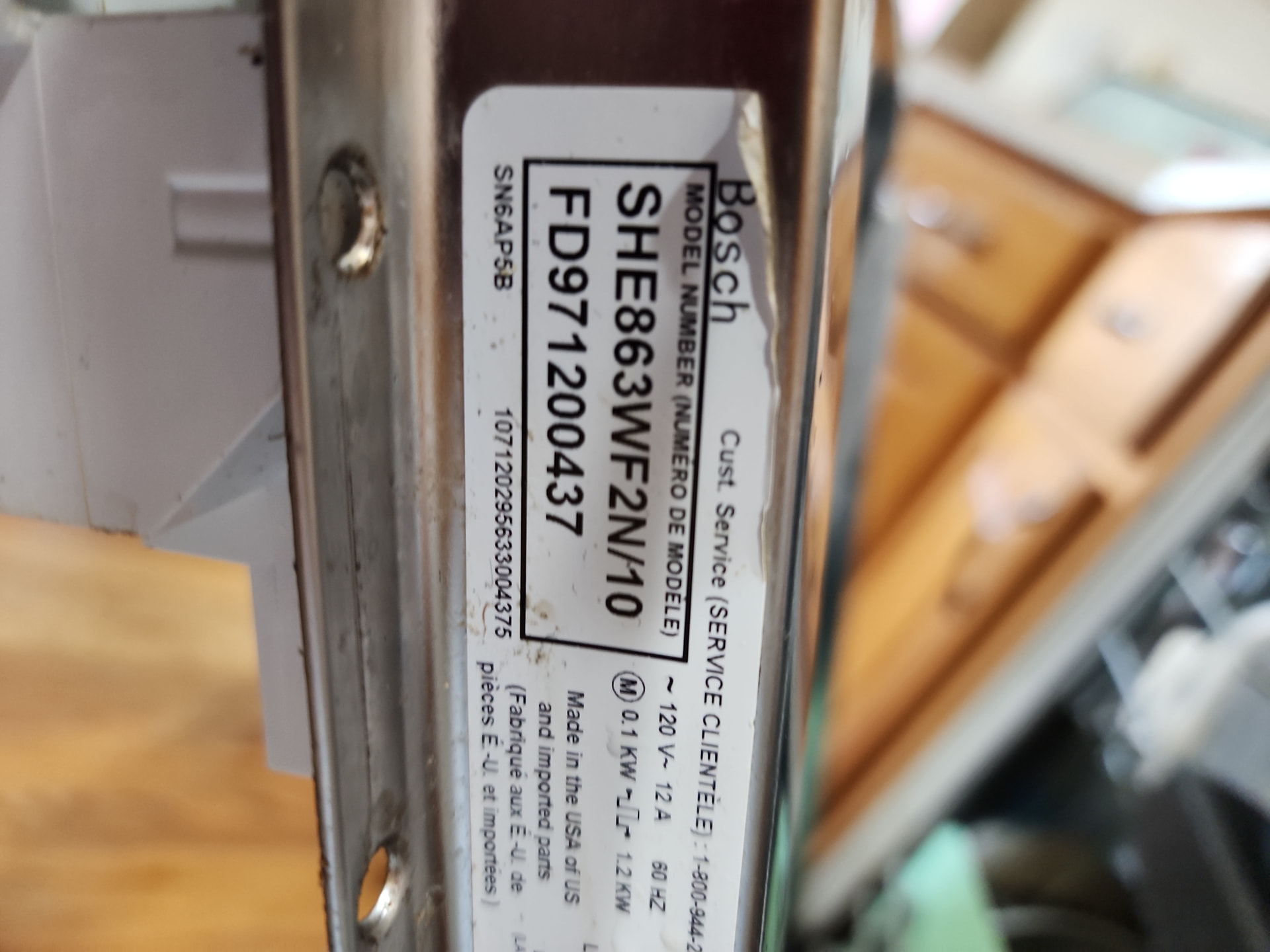

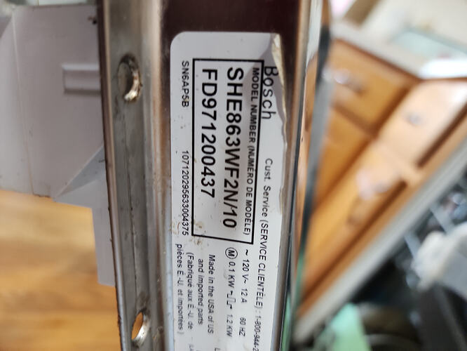

Bosch Dishwasher SHE863WF2N/10 leaking
Brand: Bosch
Model Number: SHE863WF2N/10

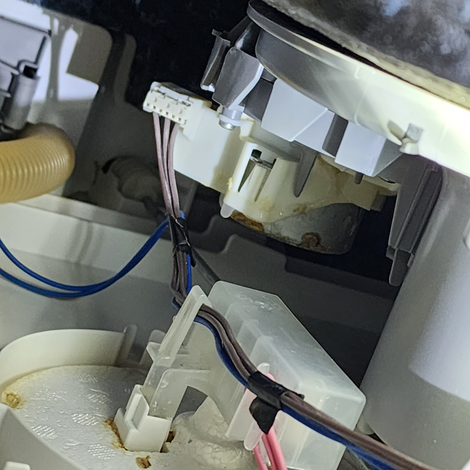

Main Symptom: Leaking into base
What happens & when: leaking when running
Error Code (if any): E15
Parts or tests already tried: none, just clean out the bottom
VIDEO-- https://drive.google.com/file/d/1KM0slipwi0R2SKeB6mvjz25AzzRqtnRf/view?usp=drive_link
It appears as if your diverter valve assembly ( Bosch 00751950 Dishwasher Diverter Valve | Genuine OEM Part ) seal is leaking
