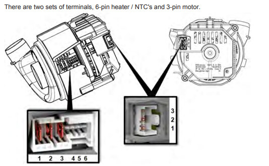

The wires going to the dispenser and the circulation pump can be checked for any loose/damaged connections. If those check good, the circulation and heat pump windings would need to be tested for resistance. The heat pump portion of the circulation pump should measure around 9.3 Ohms and the circulation pump windings should measure about 14.7 Ohms across each terminal set from pin 1 to 2, 2 to 3, and 1 to 3. Pins 4 to 5 and 5 to 6 should be about 10,000 Ohms. If that checks good, what is the full model number of the dishwasher? There should be a /## number.
