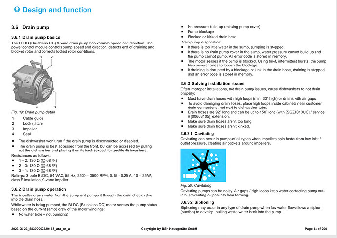

Factory reset didn’t do anything, and there were no stored error codes
Check the power connections at the dishwasher power terminal connection for loose or damaged connections. Check for loose connections at the power control module. Check the pump for high resistance or ground fault. Beyond that since it is a constantly recurring problem I would suspect the power control board or the user interface. i have attached a copy of the resistance values for the pump motor
