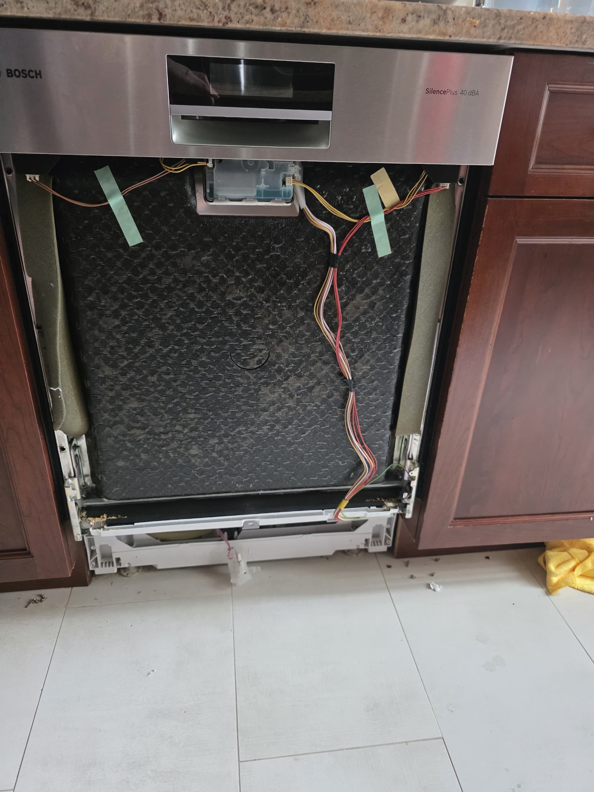

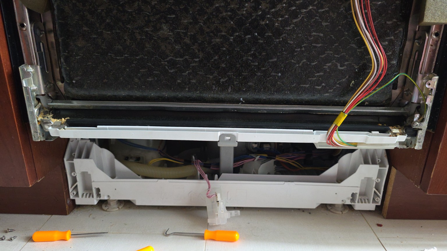

Bosch 800 Reassembly
Brand: Bosch
Model Number: SHE8PT55UC/05
Main Symptom: Leak
Error Code (if any): E15
I disassembled the front door and kickstand to check if it is leaking. I found the water inlet valve in the back leaking a drop every 20 - 30 seconds. I am going order a new water inlet valve.

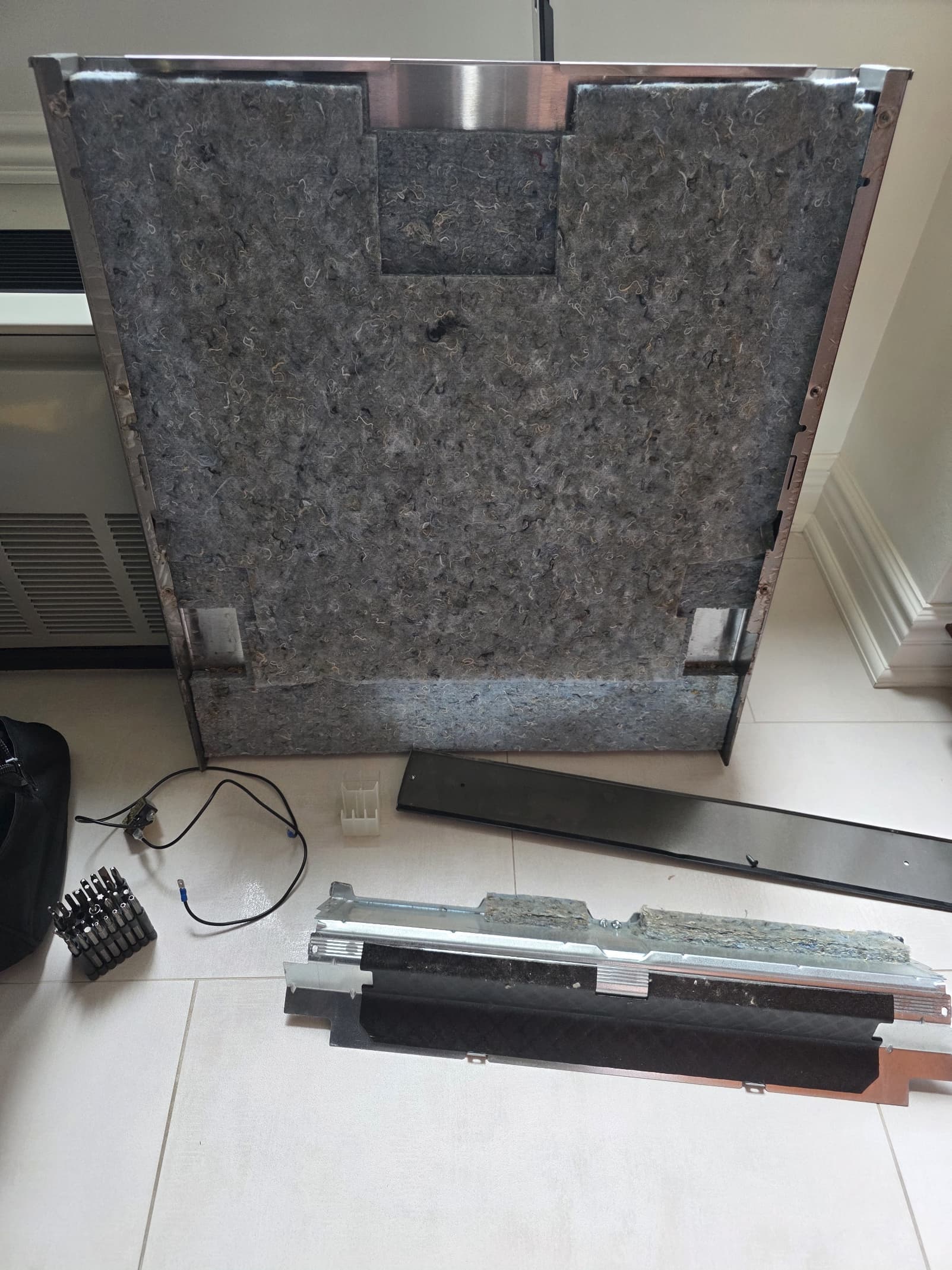

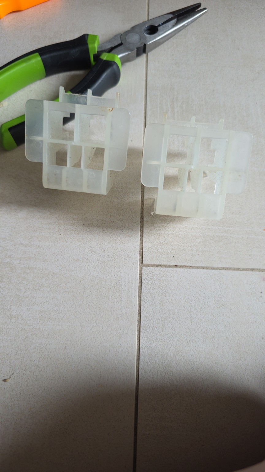

While removing the front door, two parts fell out and I just cannot find where they go.
They are what hold the outer door panel to the inner door panel. It is kind of hard to explain. They mount on each side of the inner door panel so that when you put the outer panel on, they hold it in place.
I will try to see if I can make it work when I reassemble the door. It seems like these go on first on the inner panel of the door and the outer door panel that I removed will clip on?
edit: I also tried to look at various youtube videos where they do this disassembly and none of them show this!
Still not finding where it goes. Can you point to the area I should be looking at?
Old style went on like in this pic.
Thank you so much! It even says they will occasionally fall out :rofl:

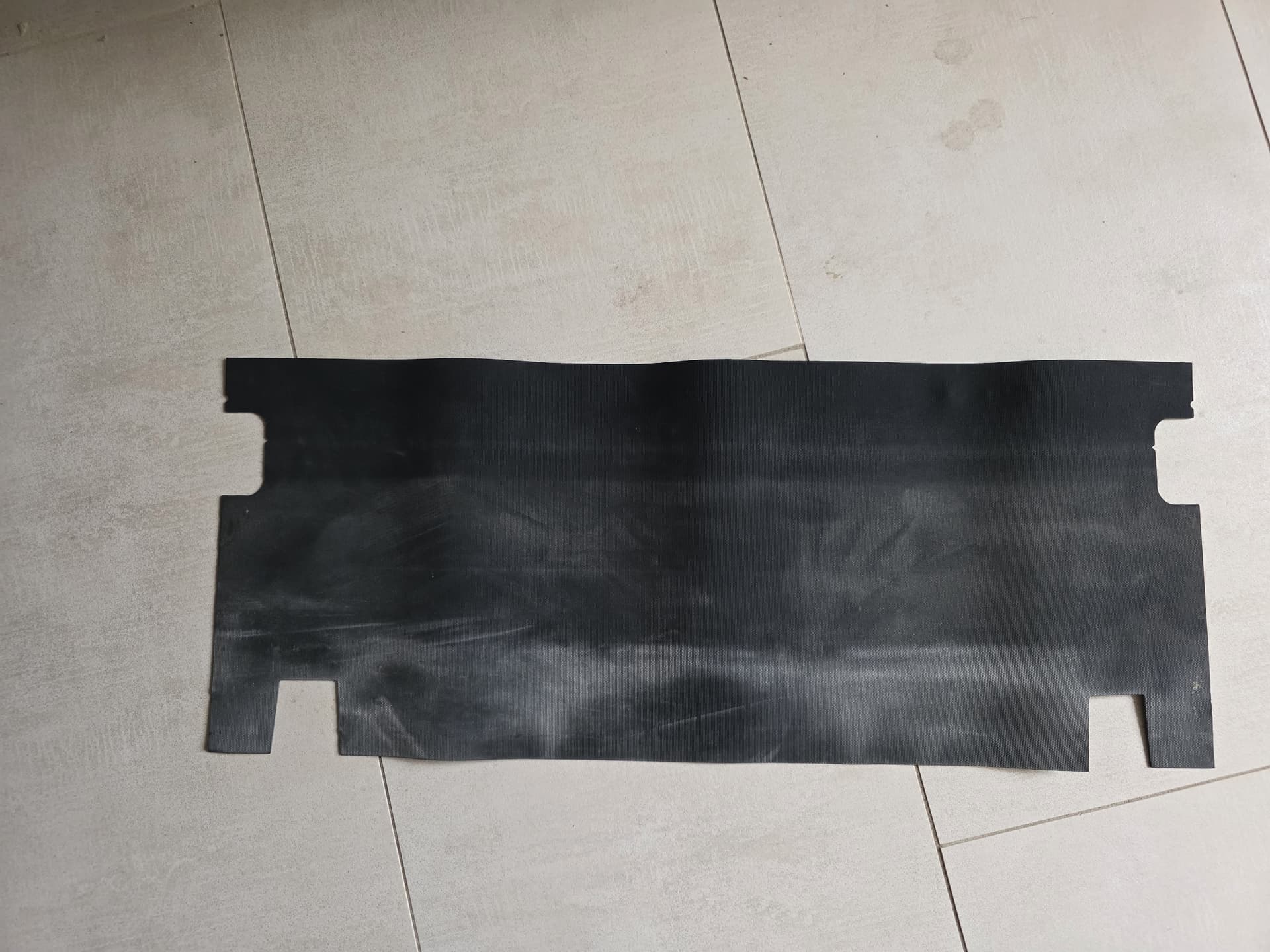

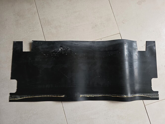

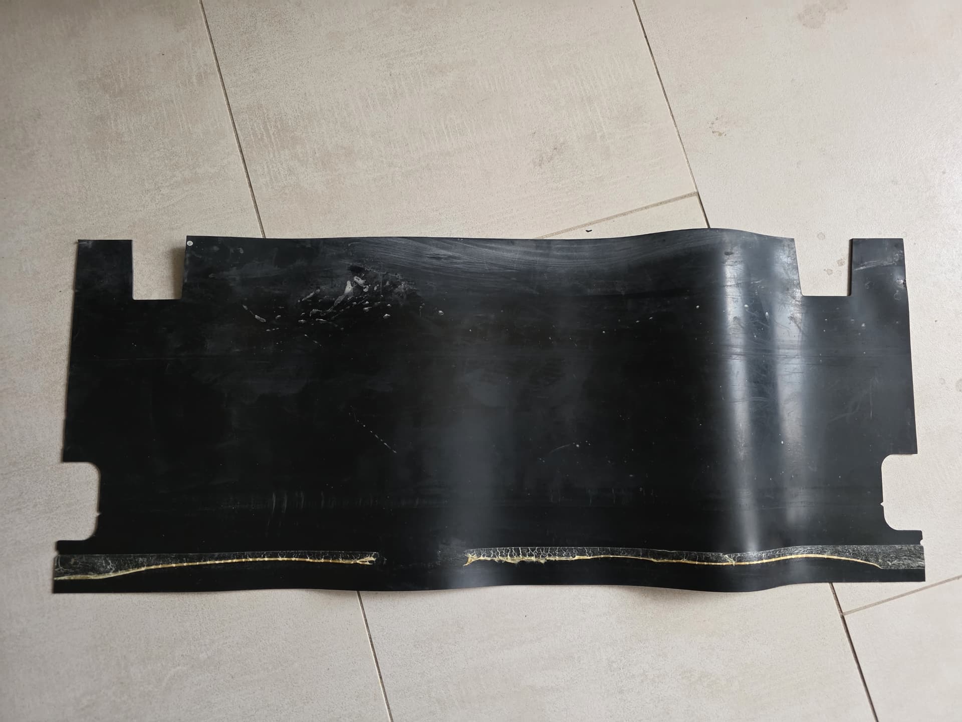

I also have this piece that fell off a while ago. Not 100% sure where it goes. Looks like I need to glue it back somewhere
I believe that is attached to the inner part of the outer door cover. The cutouts on each side look like that is where the plastic door pieces you were asking about went. not 100% on this one.
I tried to place it exactly there but it doesn’t sit well because it’s a good deal longer than the width of those door covers. The middle bulges out a lot.
looks like this is how https://youtu.be/GBFJc4ZSKiE?t=322
