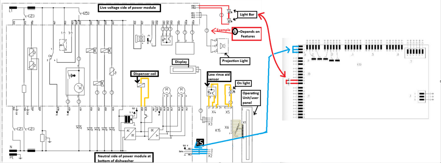

Here is a schematic of what your appliance should be wired like at the user interface control. Unfortunately, it does not provide wire colors. The door sensor would be the gray piece on the door where the magnet engages. What manufacturer part numbers are currently in from what has been replaced? For example, heat and circulation pump 0053351, programmed control module 00752744, or water inlet valve 10023852 (examples pulled directly from the manufacturer’s part information page).
Thanks again. I assume the Power Control Module, is the main module (Bottom.) What is the module above it? Do you have a full-image to share. This looks like half. I only have two modules, this seems to show 3- or parts of one. It’s confusing.
Looking at the schematic, do you know where the two LED lights plug into the main module? Are they P3 (1)? But that does not match on the side of my module. I am thinking now that maybe those LED’s do not plug in on top of my module. Looking more closely at the connections, I don’t think the metal bits line up…but I am at a loss as to where my two red LED wires connect to. Can you tell me by looking at the schematic please?

The power control module would be the control at the bottom right of the appliance while the power supply unit is the white box on the door with the user panel. From what I see, there are only two possible lights that would have went to the power control module at the bottom and of the two, only the light bar for the dishwasher interior would have two wires. The light bar, or light and cable assembly, would connect to the X10 connector at pin 5 and 6. This connection should be on the side of the power module, not on the top. However, the info light at the bottom right of the door near the hinge would have 2 wires that go to the power supply unit at the top of the door at connection X5. Here is an image of what the power module at the bottom should look like connection wise, along with the wire schematic showing where the power supply unit and the power module are connecting in comparison to where the light bar wires should be connecting.
Thanks again. I had high hopes for this…but no luck. I tested 16VDC always at the door switch wire (always on?) No inside LED is coming on and still have the two flashing lights- Sanitize and Rinse. Motor chugs for 1/2 second (self-test?) then stops. Only flashing lights. Nothing else.
Do you know any other pins I can test? Do you know how I can test to know if the POWER SUPPLY unit is BAD? It IS getting 16VDC across the pins you told me to test. No idea about if the capacitor or other components are working. Trying to hunt down this fault. I doubt 3 main modules (bottom/right) are all bad. I also tried every combination of button presses, power off, unplugged and same result.

Was the wire connection for the LEDs set to the location based on the wiring layout (side of the power module at the bottom)? If it was, and the problem is still occurring, the next step would be verifying wire connections are where they should be. This is due to the bottom power control module having 16 Volts DC going to the power supply unit in the door as there should only be 13.5 Volts DC from what I am able to find. Here is what I was able to compile on what wires should go where on the power control module based off what parts the wires are connected to. The wire colors might be different, however, this is based off of what information I was able to find throughout the manufacturer’s database for your model. If everything checks good, it would be very likely that the user interface control or the power supply unit are causing the failure. If the ribbon is disconnected from the power supply unit and voltage does not change to 13.5 Volts DC going to it, the power supply unit would be the more likely between the two. If voltage does change, the user interface panel would be the more likely.
