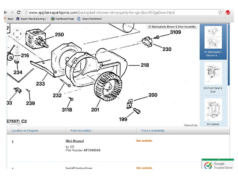

Blower fan slides down motor shaft causing extreme rubbing.
Your fan should be held in place with a retainer and screw, parts 199 & 200 in attached picture.
