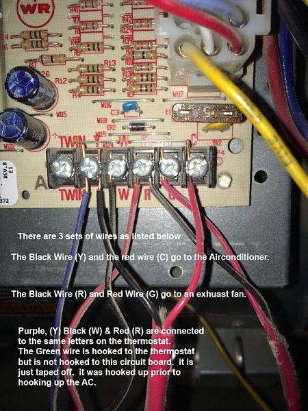

i have a trane xe80 furnace about 13 years old.
air conditioner installed about 8 years ago.
programmable thermostat - also 13 years old
Everything works good
EXCEPT.
when i turn the thermostat to ‘ON’ from auto nothing happens. (i.e. the fan does not run)
i want to leave the fan on all the time to circulate the air.
at one time the fan “on” worked, and it also worked after i had the AC installed as well.
perhaps the thermostat is shot.
any pointers on testing this. i have some electrical skills and understand most principles and know how to use a volt meter and that it is not a good idea to stick a knife into an electrical socket.
see attached picture
OK, so i looked at the wiring and think i know what is likely wrong.
4 wires go to the thermostat.
Red to R
Green to G
Purple to Y
Black to W
with thermostat on auto i have 24 Vac from red on thermostat to each of the 3 wires, turn thermostat from Auto to on and voltages to green drop to near zero.
checked out furnace wiring.
there are 3 sets of wires as follows
Wire 1 - to thermostat
Red to R, Black to W, Purple to Y, Green - taped off (not used).
Wire 2 - to air conditioner
    Black to Y, Red to C
Wire 3 - to exhaust fan
     Black to R, Red to G
So how this is set up from my understanding is that the fan kicks in when we turn on the exhaust fan.
However, i want to be able to turn on the blower fan without turning on the exhaust fan. in winter i am loosing heat by doing this, and in summer i am loosing cool air.
my question, can i hook up the green wire (from the thermostat) to the circuit board (G) so i can use the thermostat to run the blower without turning on the exhaust fan.
