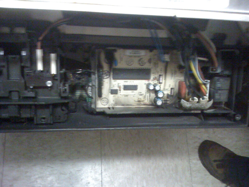

I was shocked today when I smelled smoke from an electrical fire. Followed the smell into my kitchen to see my 4 yr old Kenmore smoking and arcing blue light flashes. I ran down to the electrical panel to shut off the dishwasher breaker. We proceeded to dismantle the door to find the circuit board cooked. Lots of melted wires and black soot. I am so glad we were home! How often have you gone to bed or went out for a few hours and left the dishwasher on?

Our 3 1/2 year old Kenmore dishwasher is apparently manufactured by Whirlpool, serial number FR3305103, Model 665.17483300, Type No. 577-0.
Last night, acrid-smelling smoke started coming from the front door, and now the dishwasher does not work.
This first link is for an official recall of dishwashers similar to this one, but with a plastic body (ours has a metal body and a stainless steel front):

Apparently, even though our dishwasher’s serial and part numbers fall within the range given on both pages, it is not covered in the recall, perhaps because it has a metal body.
The defect with our dishwasher seems exactly like the one described in the recall. We are going to attempt to have Whirlpool repair or replace ours for free, since this is not a natural malfunction due to the age of the appliance or for any other reason.

Since out metal body Kenmore is not the EXACT model in the recall, they won’t repair it for free, even though the malfunction is exactly the same. They will show up in a few days and assess the problem, and if they have parts on hand (my guess is unlikely), they will repair it on the spot. The service call costs $109, which we have to pay. There was a one year warranty, and since it’s out of warranty period, we swallow the cost.
This is lame: I shouldn’t have to have to pay this, as it’s not a normal malfunction and could have burned down our apartment.
He also said that if there’s a recall, it’s unlikely we’ll get refunded for the service call and parts.
This will be the last time we purchase a Kenmore/Whirlpool appliance.
Just had a Whirlpool affiliated technician come over (this Kenmore is really just a Whirlpool with the Sears brand name). The service call was $118, non-refundable. Our dishwasher originally cost us $1,048.10, including all taxes, and delivery. I know, that’s expensive, but we thought we were getting the best, something that would last for a while, maybe ca. 10 years. We bought this on 9/11/04, it lasted four years, four months. Little did we know…
The technician’s tally for replacing the parts comes out to ca. $400. After calling Sears, they said that they could either offer Service Parts up to $100 OR Service labor up to $150, One or the other, but not both. Obviously, this is not cost efficient.
I am attaching a picture of the burned out inside of the electronics panel on the front door of the dishwasher. Notice the charred insides.

My wife started the dishwasher and left for work (I was traveling at the time.) my son was home alone and noticed the 1st floor of the house was filled with smoke when he woke up an hour later. He shut everything down.
When I got home, I noticed black soot on the outside cover, right underside (under where the control panel is.) I open the front door, removed the screws and lifted off the control panel housing to find a charred control panel, melted wiring harness and overall dead machine.

Same problem on the same model (Kenmore Elite, Stainless tub). Ran through all the same hoops with Whirlpool and Kenmore for the recall, same result. Logged the complaint with CPSC. This seems to be the best course of action. If enough people report the problem, they will issue a recall. There are already a number of incidents at SaferProducts.gov .
Obviously this is a manufacturer issue where the tub leaks into the control panel and starts the electrical fire - and it is reported on numerous models from 2004 - 2006. But unless the “exact” model number is reported, there will be little recourse.
The right thing to do is replace the seals and control boards on all these affected models, but whirlpool ain’t going to do that w/o a class action lawsuit.
