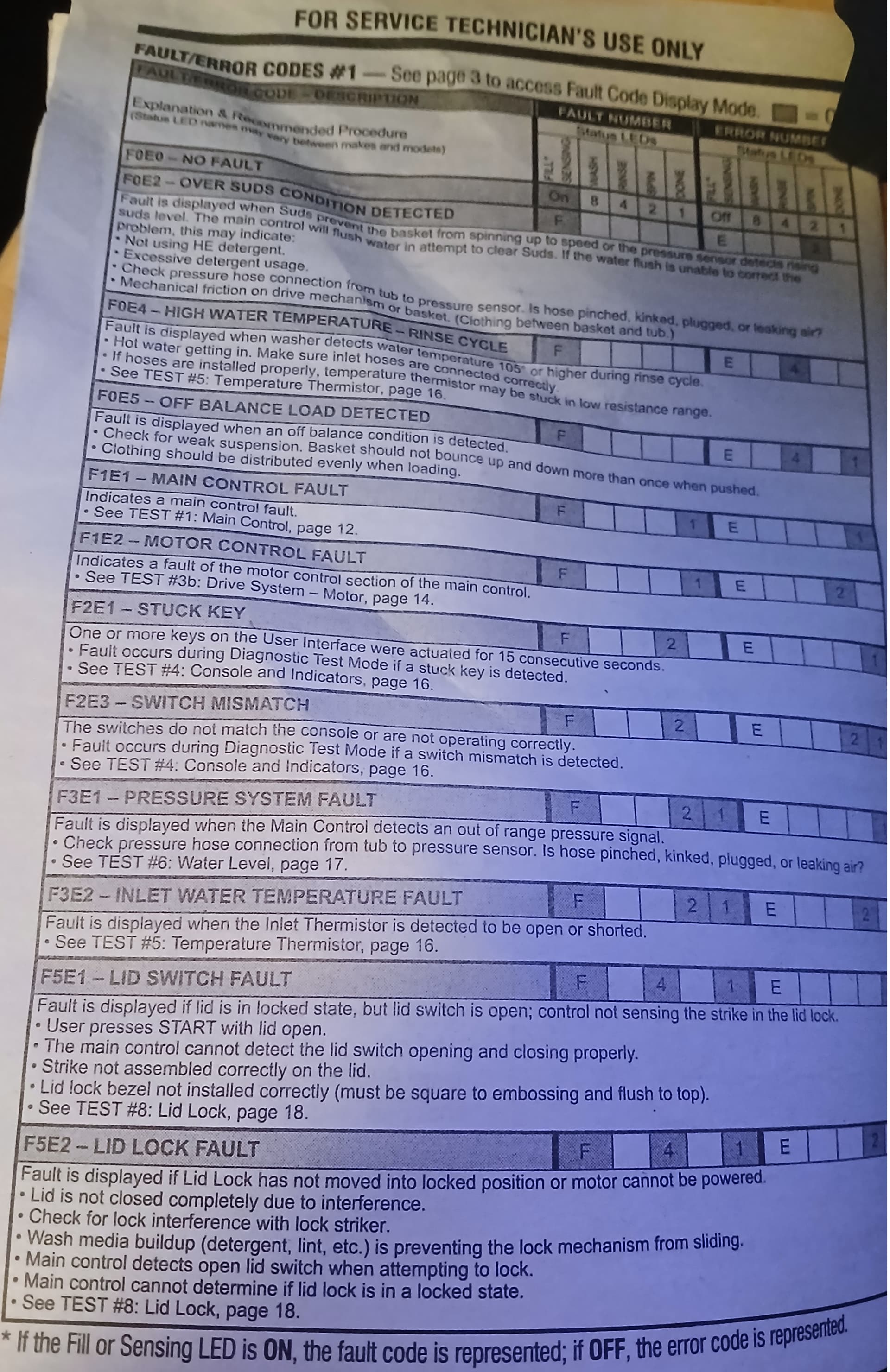

Error Code (if any):F3E1 Pressure System Fault

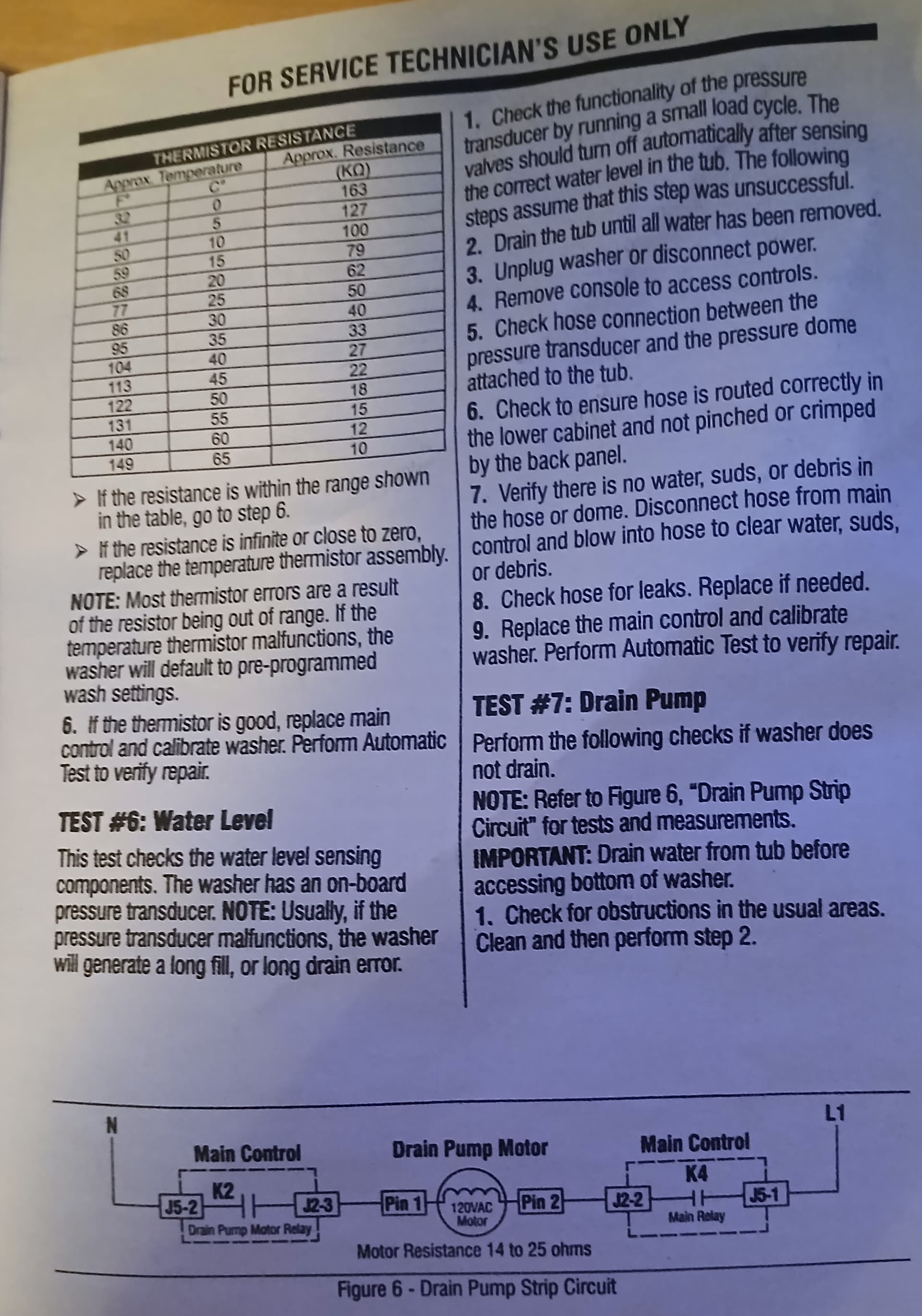

Also the error code was F3E1 Pressure System Fault. Is this noise related to F3E1 fault?
Junky washer for sure! Don’t know about the noise over the Internet,but washer more than likely has a bad control board,Read this service pointer here! W11766193.
It sounds like the drain pump is operating while empty. If you remove the back panel of the console and disconnect the pressure hose from the control, does it continue? If it does, the main control has failed. W11607637 Electronic Control Board (Main Control) | Genuine Whirlpool OEM In Stock
