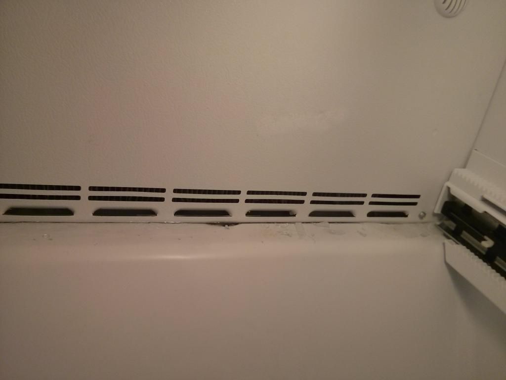

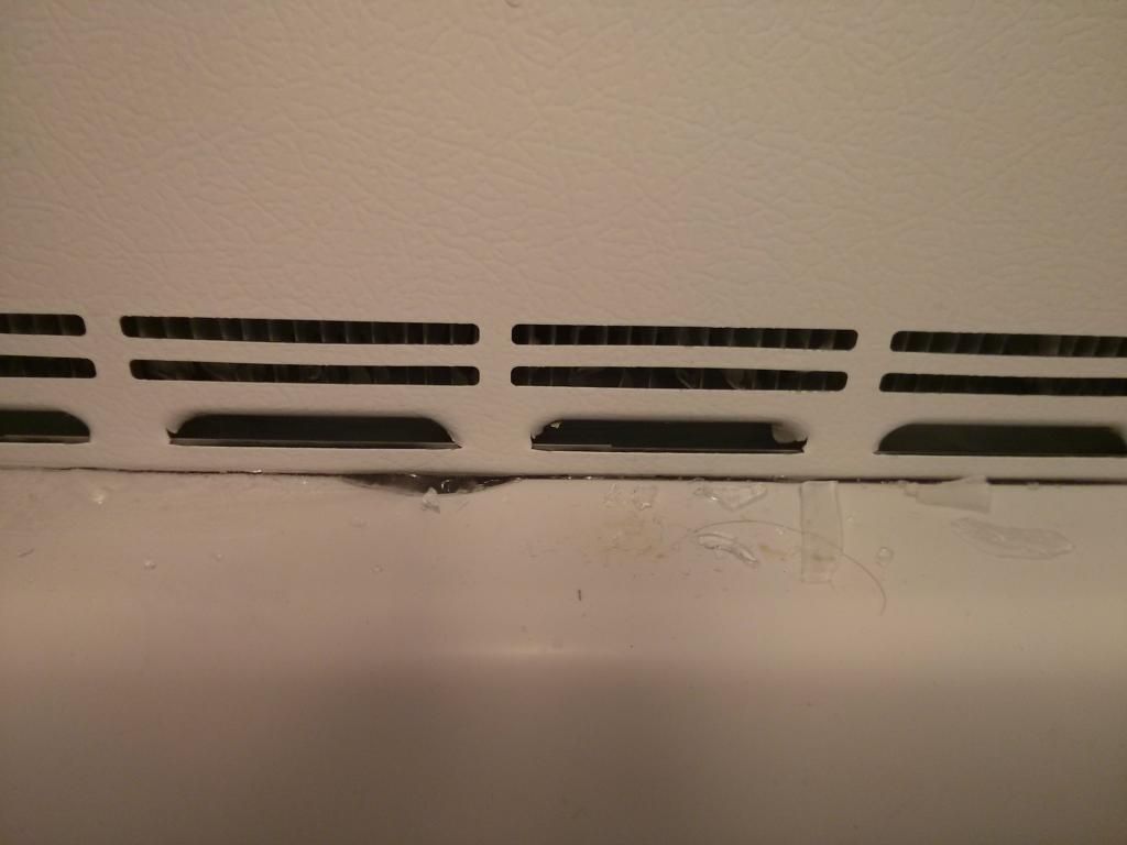

Last night I turned off the water inlet for the ice maker and this morning the bottom of the freezer compartment is dry. That is making me think the issue I have has to do with the ice maker and not the condensate drain.
I had noticed a thin layer of ice last night on the top back ledge of the freezer compartment. That ice is still there this morning but given that there is no new ice on the freezer floor - is it worth me waiting a day or so to see if the problem goes away? or does the presence of ice on that ledge indicate the drain is plugged? See photo.
It does look like the drain is clogged. Give it a day or 2 and see if the water comes back. Then you will know for sure that it needs to be cleaned out.
I took another photo and it does look like some of the condenser fins are ice clogged so I think i will open her up anyway.
Oh so you mean to wait and see if the condenser fins and drain opening clear up through future cycles?
It will not clear up on it’s own. If the drain is clogged, it will need to be cleaned out. And looking at the photos, it looks like it needs to be cleaned out.
