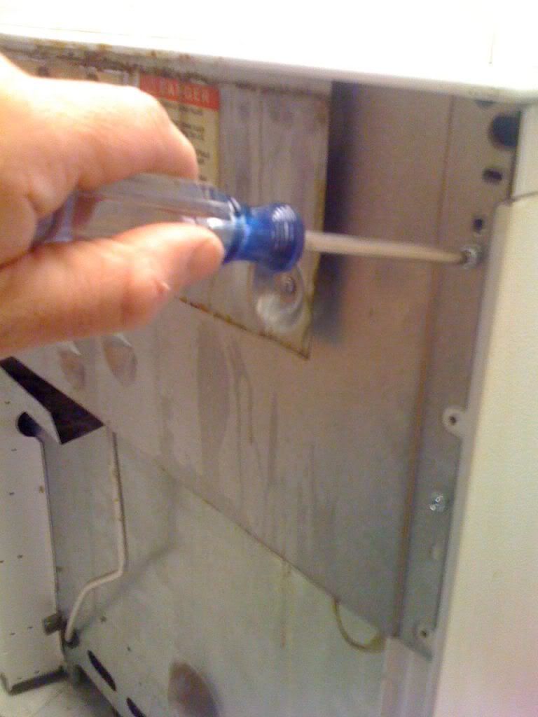

  1. shut off the gas to the stove and removed the gas line.
  2. unplugged stove.
  3. removed back panel (see pic, 4 screws)
  4. removed the oven door. (2 screws) and the oven racks.

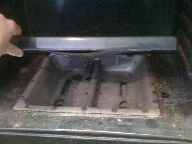

Ok. At this point it’s like I’m talking to myself because I didn’t give anyone a chance to reply before I did more digging in the parts section and found a ‘bake ignitor’ in the schematics. I’m guessing this must have been my problem all along. So for those of you in the future following my saga, here’s how to get the bake ignitor out.
  1. unplug stove, shut off gas and disconnect.
  2. open and remove oven door (2 screws)
  3. pull out drawer below door to make more room.
  4. lift broiler cover inside oven and remove
  1. locate bake ignitor and remove (3 screws)
  1. lay oven forward enough to be able to reach under the bottom. (I just tilted mine all the way onto it’s front)
  2. locate green plug that is coming from inside oven (It’s difficult to see in the picture but when you actually are doing it, you can see the green plug through the hole at the bottom left on the back of the stove)
  1. unplug and remove bakeignitor through the front.
This is as far as I got as I’m waiting for the part, but I assume, it’s pretty much the same in reverse. Just take the guard off the old ignitor and put it on the new one. Here’s a pic of the part I’m calling bake ignitor as opposed to the earlier post when I replaced a larger flat ignitor and called it oven ignitor.
