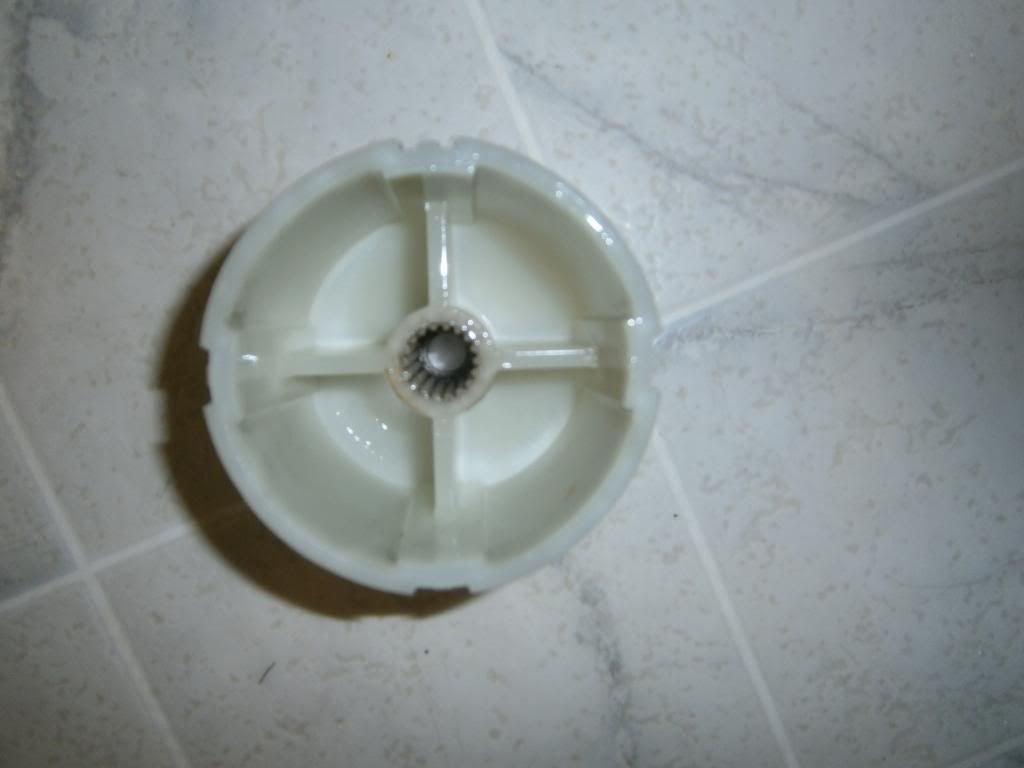

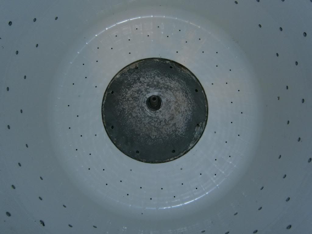

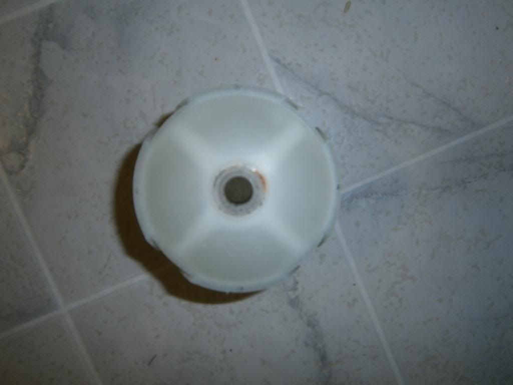

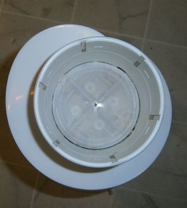

Thank you all for your replies. I have removed the agitator and now cleaning the coupler to see if this is the problem. The agitator only agitated slightly and seemed loose. I’m trying to separate the two pieces to get to the dogs to see if they need replacing but I can’t get the two pieces separated. There is a little dust cap but it doesn’t have any handles where I can just lift them off. I’ll attempt to send you photos if I can so you see what I mean.
Sorry for such big photos. I was having such a hard time adding them together in one post.
If the top half of the agitator rotates freely in one direction and not the other, then it is fine. If it rotates freely in both directions, you need to replace the whole agitator. GE did not design that agitator to be repaired like the Whirlpool design. The coupler looks to be ok although hard to tell as the pic is not clear. If you cannot forcefully rotate the coupler when it is on the agitator shaft, then it is ok.

Hello everyone. Ah ok cause I couldn’t find anything for my kind of agitator. I checked the coupler and there are no cracks in it or anything. The top half of the agitator rotates one way but not the other so that’s ok. When the bottom half was on the coupler, it could rotate easily both ways so I’m going to install it back on and maybe it just came loose and needed to be pushed down more. If that is all there is, at least it gave me a chance to give it a good cleaning. If it doesn’t work, I will be back to ask more questions.

No, it should not rotate freely. Either the internal splines of the coupler are stripped or the agitator shaft is rotating freely which means the transmission is bad. Try rotating the agitator shaft by hand with the coupler off. You should not be able to do so. I am assuming this is a GE T-style washer, I’m not finding much information on the model number given. Hotpoint is made by GE. Can you provide a pic of the lower part of the washer with the front panel removed?
