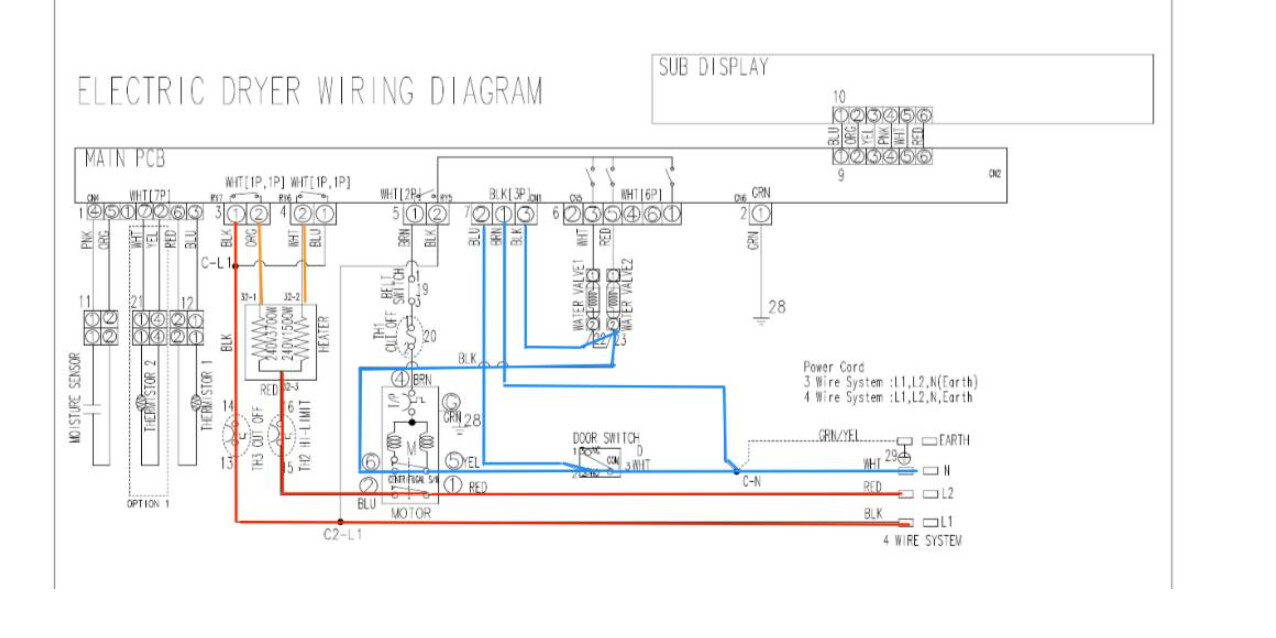

After spin drying for 20 min.s everything shuts down. no power
Brand:samsung
Model Number:DV419aew/xxa
Main Symptom:quits spinning
What happens & when:after 20 mins spinning everything tur off. wont power up.

Based on the symptoms you described, the most common cause is a failing drive motor. As the motor overheats, its internal thermal protector will shut it off. Once it cools down, it may run again for a few minutes before stopping, which is a classic sign of a motor that’s wearing out.
I cleared out a hugh mat of lint out of the cover that goes between the lint door down to the blower wheel.There was also lint wrapping onto and into the wheel. I cleared the wheel and ducting completely out. all the way to the wall.Perfect air flow. no obstructions. On checking ‘Low voltage’ the 220 power cord the dryer is using is over twice as long as the original,consisting of two cords plugged together to get to the wall socket. Could the longer distance/cords cause a problem? Everything has worked fine before with the previous dryer. It could be three tilmes longer,I dont know. What should it read when i put the meter on it? Thanks for your help,I wish i could put this to bed,I figured pulling out that massive amount of lint would have fixed it. Probly just put a heavier strain on all the other components.

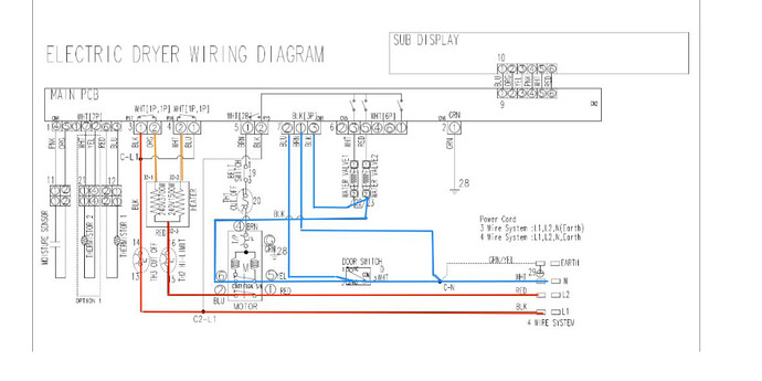

Main PCB to Motor Control Layout
The main control board supplies 120 VAC (L1) to the motor through the motor relay. Before power reaches the motor windings, it passes through the belt cut-off switch. If the drive belt breaks or slips off the drum, this safety switch opens, preventing the motor from running or even humming.
The neutral (N) side of the circuit passes through the door switch. Opening the dryer door breaks the circuit immediately, stopping the motor.
Motor Terminal Block Wiring
The drive motor uses a standard 6-pin terminal block. The wiring is as follows:
Pin Wire Color Function
Pin 1 Red Routes to the high-limit thermostat and heating element circuit.
Pin 2 Blue Supplies the main start/run windings through the control board relay.
Pin 3 Black/Orange Connects to the internal centrifugal switch, which closes the heater circuit once the motor reaches operating speed.
Pin 4 Brown Connects to the thermal overload protector and belt switch safety circuit.
Pin 5 Yellow Sends a feedback signal to the main control board so it can detect that the motor is running.

Troubleshooting
Motor hums but won’t tumble
  • The motor’s internal centrifugal switch or the start winding may have failed.
  • With the dryer unplugged, check the resistance between Pins 2 and 4. An abnormal reading may indicate a defective motor.
Dryer is completely dead or the motor won’t run
  • Check the belt cut-off switch first.
  • Push the idler pulley arm into the belt-tension position and use a multimeter to test the switch for continuity.
  • If the switch is open while the idler arm is engaged, replace the belt switch.
These checks will help determine whether the problem is in the safety circuit, wiring, or the drive motor itself before replacing any parts.
