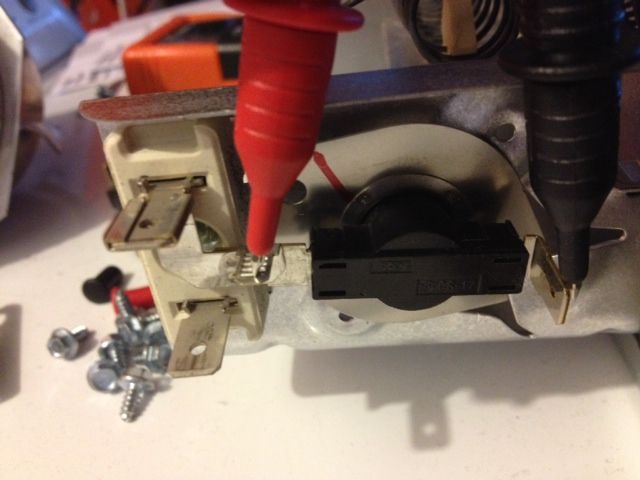

The only thermostats I see people testing on videos are two-pronged but this one is 4. Here I’m testing for continuity on this thermostat and getting nothing, BUT…

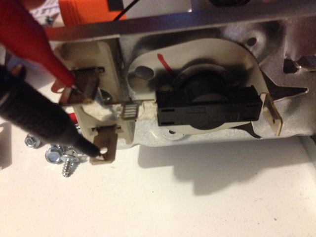

…this is testing the opposite prongs on the same thermostat and there IS continuity. The picture above shows me testing the prongs that connect to blue wires while the prongs pictured below connect with red wires.

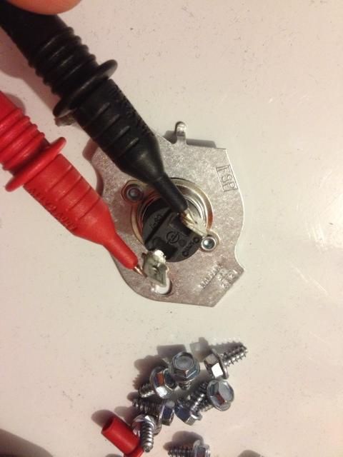

I think this is the thermal fuse? It DOES have continuity.
I think this is a thermostat. It connects to the heating element and also has continuity.

[COLOR=“DarkGreen”]1[/COLOR] Operating Thermostat Heater.
This is an internal heater, it adds heat to the thermostat when using lower heat settings. This causes the thermostat to cycle more often reducing the main heaters output. They are usually in the 5,000 to 10,000 ohm range.
You may be using too low of a meter scale so it reads as open.
[COLOR=“DarkGreen”]2[/COLOR] Operating Thermostat Contacts. Should read zero ohms at room temperature.
[COLOR=“DarkGreen”]3[/COLOR] Thermal Fuse should read zero ohms.
[COLOR=“DarkGreen”]4[/COLOR] Thermal Cutoff should read zero ohms.
[COLOR=“DarkGreen”]5[/COLOR] Hi Limit Thermostat should read zero ohms.
