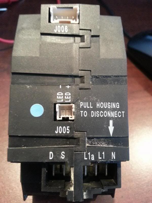

I have my front 2 burners out on my kitchenaid KESA907PSS. Service came by to diagnose the problem and said it was the infinite switches without taking a part the unit. Quote was $500 for the repair. I passed when I saw the cost of the switches online. btw. both burners act differently. One will have a slow flashing led and not turn on. the other will either have a quick pulsing led and click or not illuminate at all.
I removed the control panel and pulled out the switch on one of the burners that was bad and one that was good to get a comparison with the meter. My switch looks different than the ones I see posted with the components D, S, L1a, L1,& N. With the switch in the off position i am only getting a reading with my leads on L1 & N together on both switches. The reading flashes for a second and goes back to 1. I get different readings each time on both.
Trying to get a little help on how to properly test this switch. I have tested in the off and on position and there is not much difference.
This is what my switch looks like:
Appreciate any help.

Looking at the switch I think you have a 00 or a 01 unit.
Attached is the wiring diagram for this unit.
Note that a 02 unit is different.

Looks like the switches come as a kit (item 11 in section 02 of the parts).
A kit is usually an indication that there has been problems with the older set up.
I think the 02 units use the new style switches.

Any advice on how to test? Was using the multimeter as stated above but not really sure if I am doing it right or what I am looking for.
[COLOR=“Blue”]Any advice on how to test?[/COLOR]
See 5-1 page in the service manual.
This just checks the switch contacts inside the infinite switch.

I did swap out a good working switch to both burners that were not working and have determined that the switches must be at fault and not the element.

Ok So i just put in a new wiring harness and switches that i ordered but on the new switches there is not a connector for the stove top light that shows when the burner is on. All burners are working now.
I do not see any place on the new switch to plug in the wire.

figured it out. Didnt realize one of the wires was an actual light. thought it was just a fuse.
Still dont have the light coming up showing the surface is hot but that could be all on me as well..
