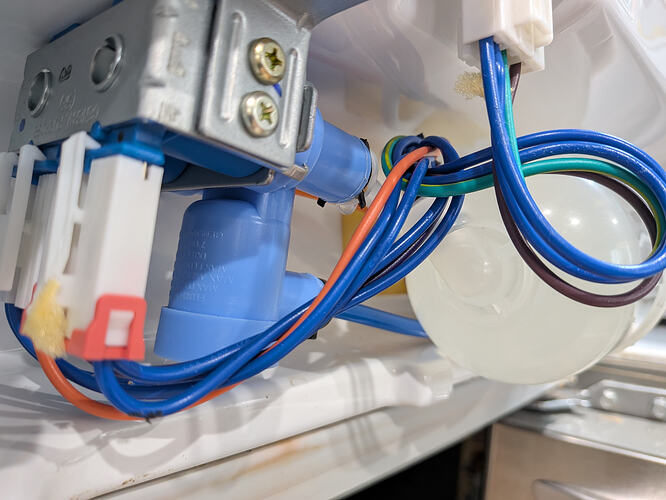

Will replacing AJL72911507 fix the leak shown in LG LFX25973ST?
Brand: LG
Model Number: LFX25973ST
Main Symptom: Leak in water line
There is a water droplet forming as shown in the attached image. Water from this leak pools on top of the freezer drawer below where the doors meet, and also on the floor on the left side of the refrigerator.
Pushing the hose into the fitting firmly does not fix the leak. I assume the problem is with the fitting. It looks like the fitting is part of AJL72911507. According to the listing on appliancepartpros.com, that part is not compatible with my refrigerator, but according to Arvin T. (appliancepartpros chat) and lgparts.com, it is compatible.
Does it look like replacing this part will fix the leak, and is that something I can probably do myself? Is there a better solution?

Thanks. Based on your reply, it sounds like this is something I can do myself.
I wanted to clarify that the water tank - which is located in the left door underneath the water dispenser, not in the fresh-food compartment behind the crisper drawers - is not the part that is leaking. The leak is in one of the push-to-connect fittings, as shown in the attached image, and the hope is that by replacing the whole assembly (which incidentally includes a new water tank) will fix the problem. If you’re able to confirm that, I’d appreciate it. Thank you!
Based on the image and where the leak is occurring, replacing the assembly should correct the issue.
