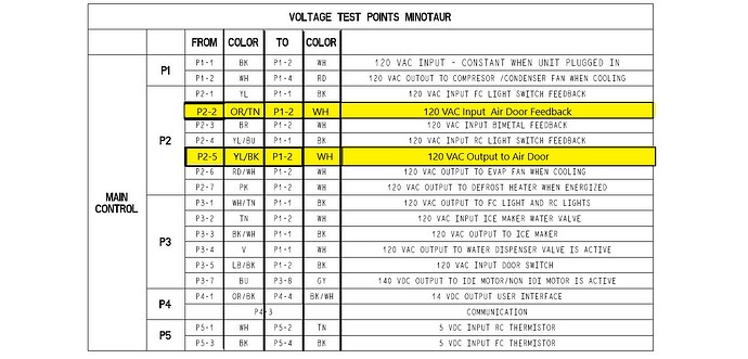

I followed the diag steps outlined in this video - https://www.youtube.com/watch?v=zb4WauhlXDM - and test 1 and test 2 show “01” (freezer thermistor and fridge thermistor I believe) and then test 3 is supposed to test the air baffle according to the video. it switches from “01” (open) to “02” (closed), so you should feel air moving in the fridge and then not. The air flow DID NOT cut off when it switched to “02”, so perhaps this is conclusive of at least one problem???
If the air baffle is failing to function properly, could this cause both symptoms I’m experiencing?

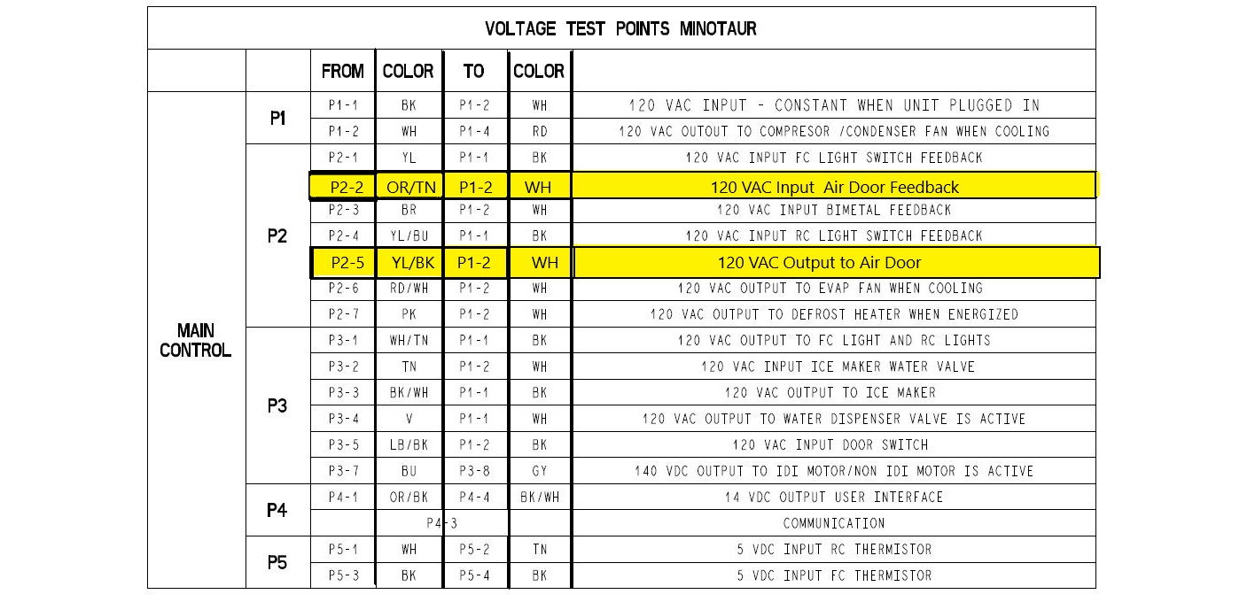

The damper not closing could be the complete issue. ensure it is operating (closing and opening). I am attaching the tech sheet with some test points.
serviceandwiringsheet-w10373993-revc.pdf (660.7 KB)
Does this require a volt meter or something similar to test?

You will need a multimeter to test it. Is it worth repairing is a personal preference.

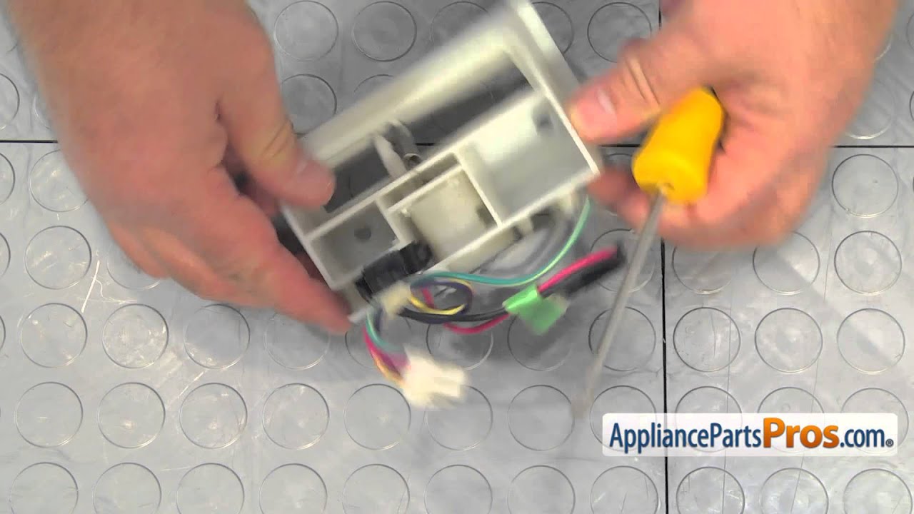

I think I could do this myself, but I’m looking for a video or instructions that show something closer to my actually refrigerator model. The video provided earlier is quite a bit different from mine.
thanks!
We do not have a video of the exact damper as yours, but here are a couple that may be closer to what you have…
