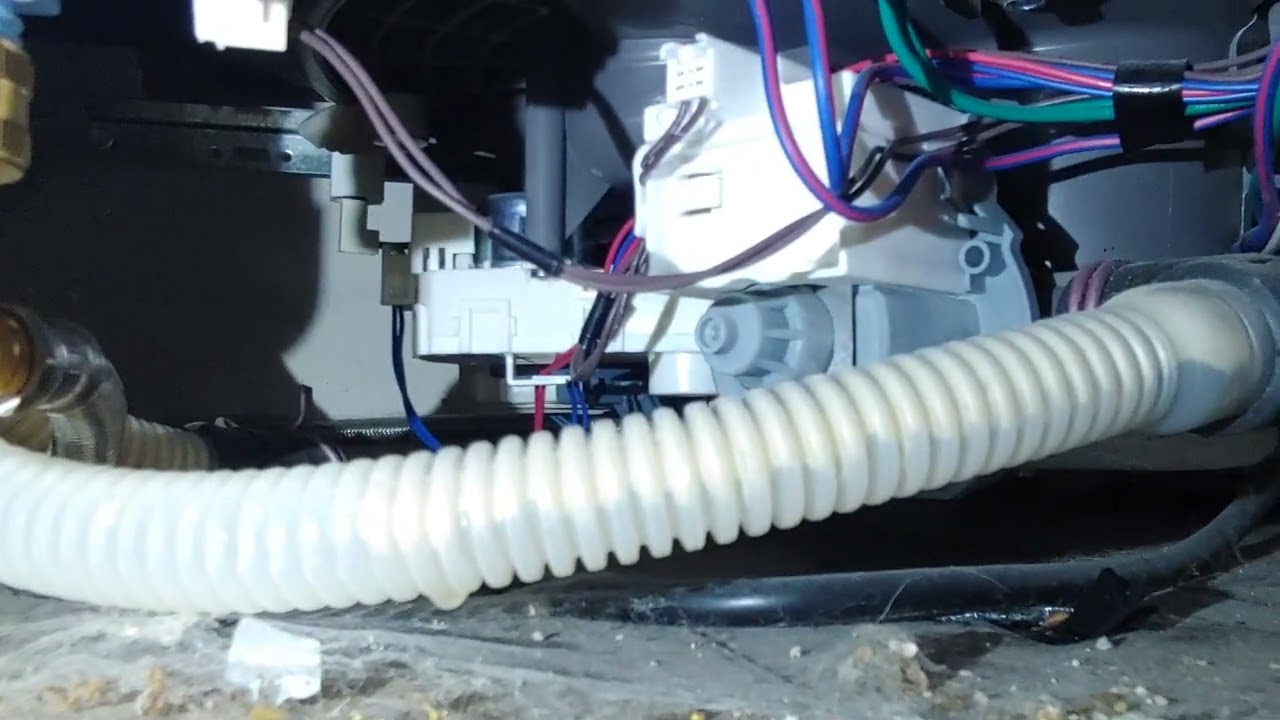

The problem with the dishwasher is intermittent. It sound like its trying to fill, but there doesn’t appear to be much water in it. The timer counts down and the cycle completes, but the dishes are not washed. I can manually add water to the unit and it seems to make a difference, I have also tried pushing hard on the door a few times before starting - might be placebo effect.
Given that the unit seems to think its functioning normally by completing a cycle, I am thinking its not a control board problem. Lack of water has me leaning towards water valve.
Any other thoughts? Here is a video of the unit when it is running:

[*]Water seems to fill to be ready for wash cycle (is never super full, barely getting to the base tub level/door flange), but the circulation pumps kick on fairly loudly on first burst for about 3/4 to 2 seconds, but immediately shuts off. Then the bursts are usually no more than .5 seconds for about 20 cycles. Some water somehow gets sprayed on the top dishes but the bottom and detergent door doesn’t ever get sprayed enough to clean out the detergent bay (and no, not over filling in any way).

[*]replaced the motor assembly circulation unit. (NO CHANGE)
  • I have checked the voltage on the control board, no fuses are open.
Diagnostic Cycle Results:
What is super frustrating is that the diagnostic readout for User Errors consistently says 4 - 3 meaning the motor is bad. We have already replaced the entire unit.
I have run the diagnostics many many times leaving it completely alone, and tried to clear the User Error at the right time pressing Hi Temp button right after the error display segments, and have never felt it cleared anything really.
Initially the Service Errors AND User Errors would flag the motor 4 - 3 and the 7 - 1 heating element, but after trying to clear the User Errors there are 0 Service Errors shown now after completing the full uninterrupted diagnostic program and User Errors now just reads 4 - 3.
All of the segments do seem to do the proper engagements of each system as the circulation pumps also engage as they do briefly just as in a regular wash cycle.
This shows that both fuses are open, and I have checked them with an ohm meter as well. It starts off .3 dropping to .2 and .1 and then 0 resistance.
The water level never really reaches up to even move the overflow float, and I have live checked the overflow switch to see that manually engaging it while filling cycle stops when it’s triggered. It functions as expected - the flow immediately stops.
**So, there seems to me to be the only remaining possible issues: **
  1. Wiring connection issue between Control board and Pump connector
  2. Inlet Valve is partially blocked (we have horrible hard water)
  3. Possibly something bad with the turbidity sensor.
  4. And who knows, maybe the ground connection is losing it’s strength?? It’s hard wired to the electrical circuit.
My hunch is on Inlet Valve, with possibly an assist by wiring connection issue.
I don’t know how to “clean” one of the tiny wiring connection prongs as has been mentioned by another post. If anyone has some details on that I would be much obliged.

I ran diagnostics and got an F2E1 and a F6E4 code out of the machine. Checked the water inlet valve, its wasn’t clogged and seem to be flowing well.
Left power off for about 10 minutes - trying another wash cycle now - will see what happens and if the same codes are there when its done.
