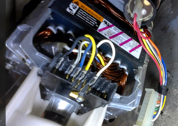

Main Symptom: Agitator (motor) does not turn during Delicate wash cycle with AppPartsPros replacement motor.
What happens & when: After water fill, machine just stops - no agitator action.
Error Code (if any): none
Parts or tests already tried: Works OK (mostly) during “Normal” wash cycle. Normally, after main washing, machine goes into ‘delicate’ mode (agitator turns slowly). With APP replacement motor, no agitator action until end of that part of the cycle. Then machine picks up from there. With Delicate cycle, no agitator action at all. Connected original motor and motor spins during Delicate wash. Expect motor is not the correct part, as there is a wire missing on replacement motor. APP website picture shows this wire (purple near top of connector -see photo on link) which is on the original motor, but not on the replacement motor..

Original motor connector wiring:
Blk | Purple | Wht w/blk stripe | Blue | Yellow | empty| Wht
APP replacement motor:
Blk | empty | Wht w/blk stripe | Blue | Yellow | empty | Wht
Looking at the pump end of the motor shaft.
BTW: There is no terminal in the connector / harness for the Blk wire.
What is the next step to getting this resolved? Does APP have the correct motor?
I thought it might help if I could post an image of the new motor delivered by APP. This image shows both the electrical connector with the colored wires, and the part number at the top (it’s a little difficult to read, but if you enlarge it, you can see the number):
Part number: W10153111.
Both the APP web page and the Whirlpool web page for the motor for this machine shows the motor part number as: 3951550.
So this would tend to indicate that the motor delivered by APP is NOT the correct motor for this washing machine.
What’s the next step to get this resolved?
Thx for your help.
Sorry forgot to attach the image.
Yeah, that’s the wrong motor for sure.That one fits the whirlpool dryer or kenmore that has 4 drum rollers!
