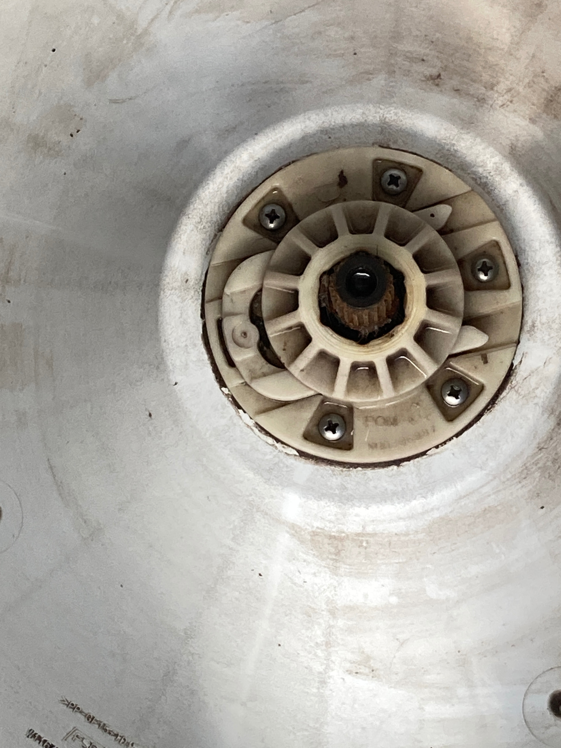

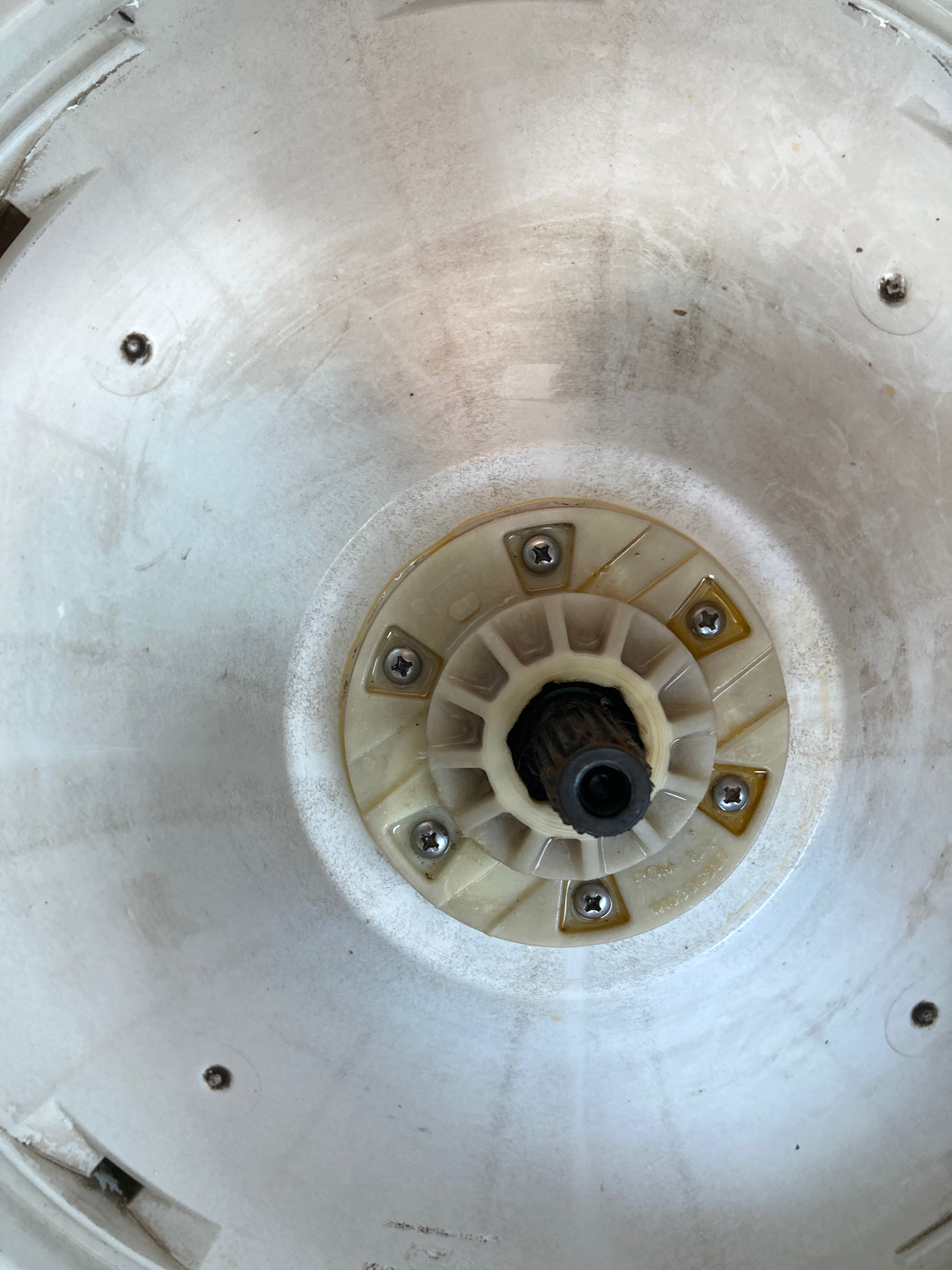

Whirlpool Washer 2in1 Model wtw4957pw0 removing basket from tub - should lift straight out according to video
Brand: Whirlpool 2 in 1
Model Number: wtw4957pw0
Parts or tests already tried: Removed the washer drive hub retainer
There is some corrosion around the shaft, you may need some WD-40 and even remove the 6 screws to get some slack to be able to lift it out.
