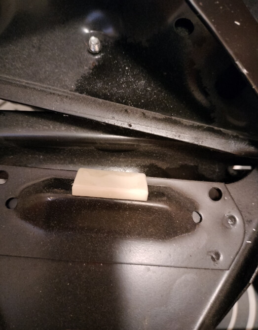

I was unaware that it has upper and lower pads. I only can see lower pads. This is what they look like; some wear, but smooth and unbroken:
Based just on that photo, they do look worn. I would recommend replacing the pads upper and lower. If you look up from where that pad is, you will see the upper pads.

I am still not seeing any upper suspension pads. Here are the three surfaces that mate with the lower stabilizer pads. Are they somewhere else?

Here is a photo of where the pads are located.

Thank you. Although mine look good, but I will go follow your recommendation and replace them if you say I should. I think I’ll also replace the Washer Centerpost Gasket while I have it apart. Please let me know your thoughts on these.

I’m following up to see what your thoughts are on those pictures I uploaded. Do those upper pads look like they need to be replaced? Do you recommend anything else besides the Washer Centerpost Gasket?

The upper pads do look good and you should definitely replace the lower pads. As for replacing the centerpost seal, you can do that but usually do not need to unless there is a leak.
