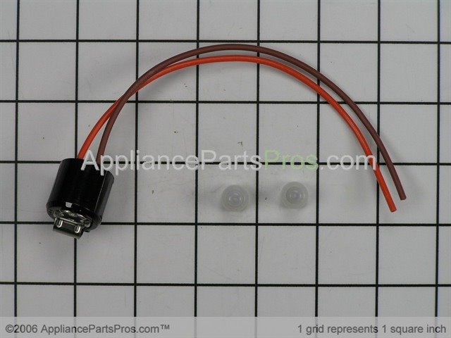

Defrost Thermostat Kit
That would be a prime suspect yes.

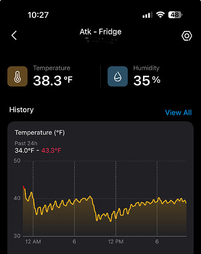

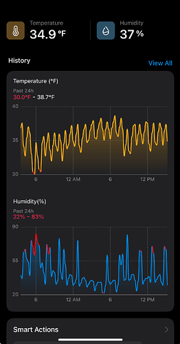

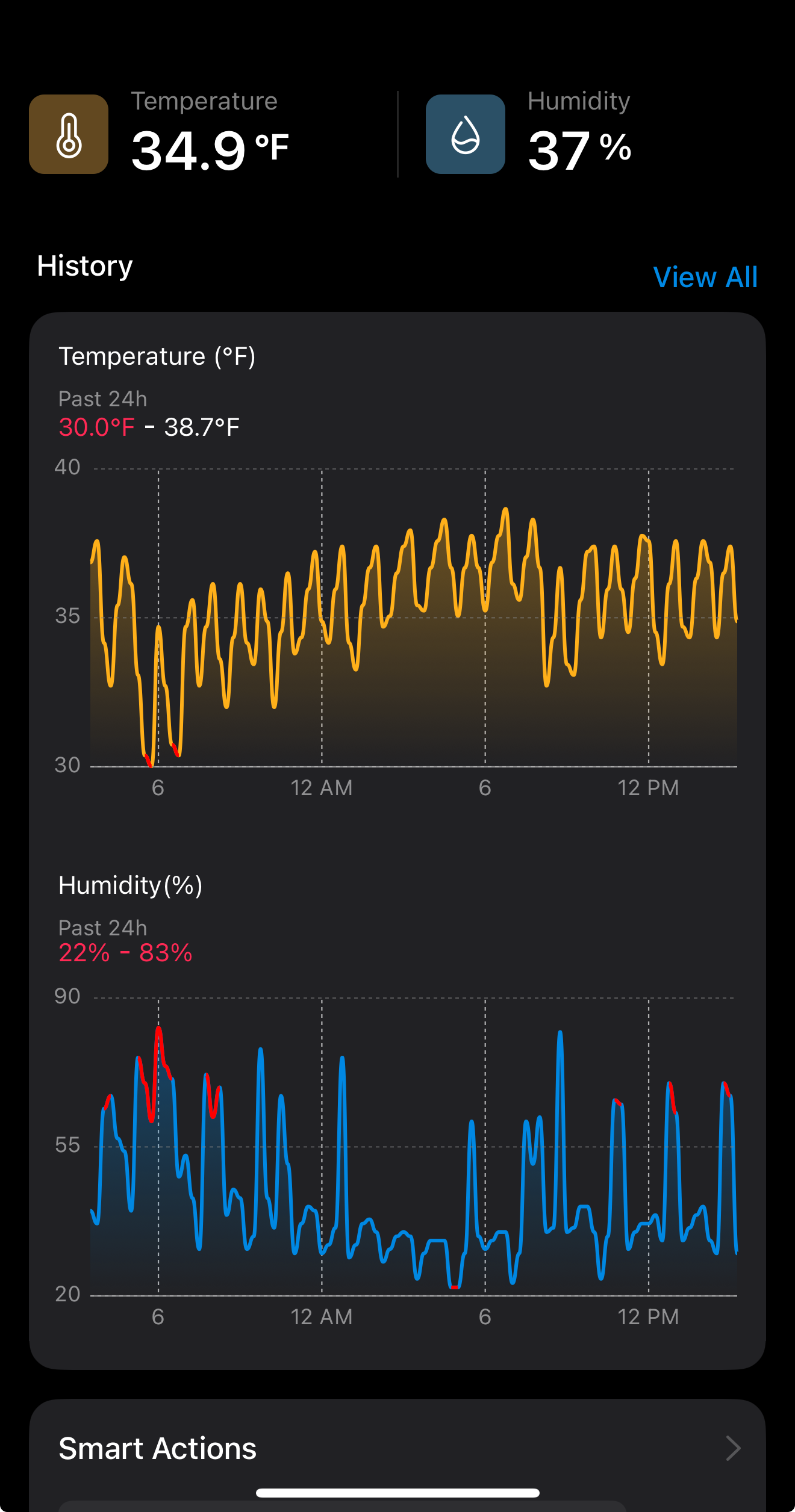

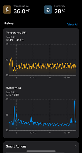

As of now, the attached pics shows the last 24 hrs. The fridge has been set to setting 5. No ice build up either, so defrost working normally. If I didn’t have a temp monitor in it now, I’d have no idea the temps fluctuated this much, as everything appears normal, and the food is cold. For comparison, another smaller whirlpool fridge I have in the basement running, is much more stable.
Maybe this is “normal” operation?
Kitchen Fridge that’s been fixed
Older whirlpool in basement, for comparison
Yes, we always need to wait 24 hours after making a temp change for it to really do something.
We all loved the older mechanical temp controls…if 3 is too warm you could go to 3&1/4 (wait 24 hours) and then retest, if still too warm you go to 3&1/2 (wait 24 hours) and so on…but the electronic controls with numbers only don’t give you that same control. Our main refrigerator has the older mechanical controls!
Your charts do show the older mechanical control does appear to be more even in controlsing the temps!
