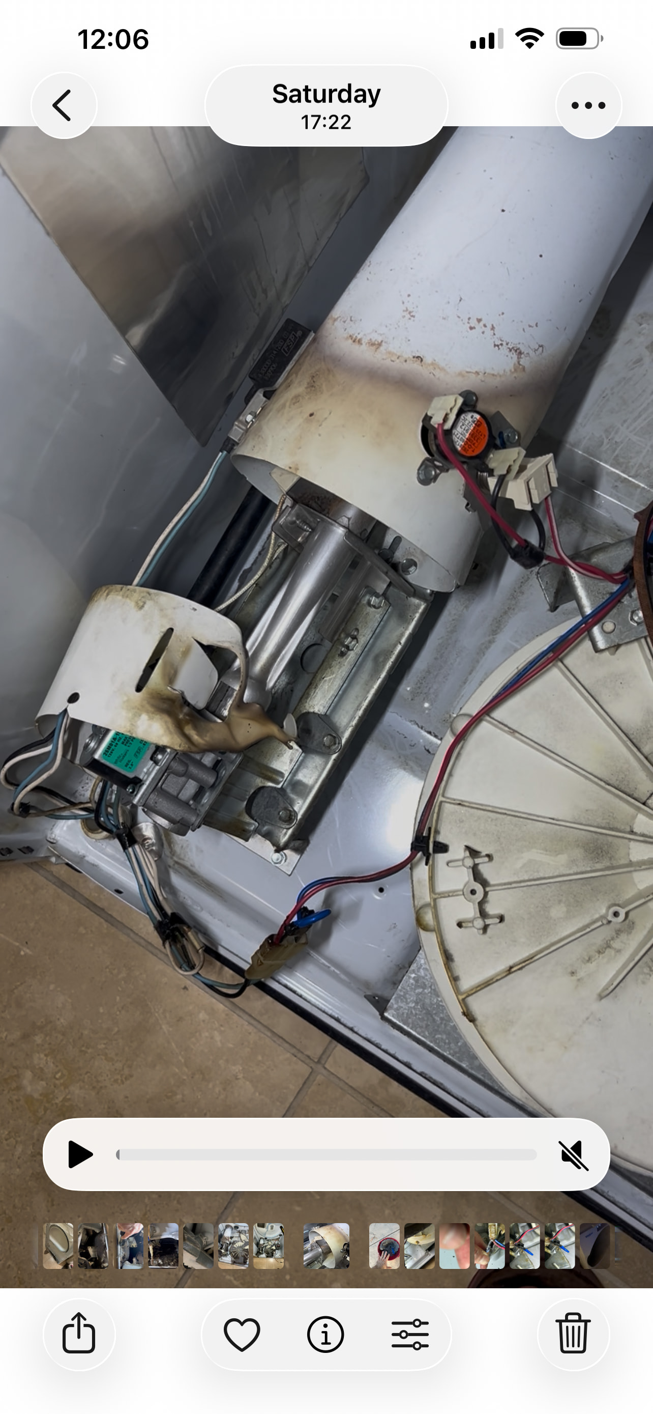

Main Symptom: burning smell when running

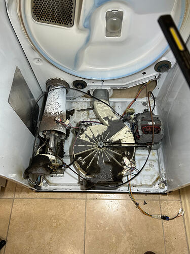

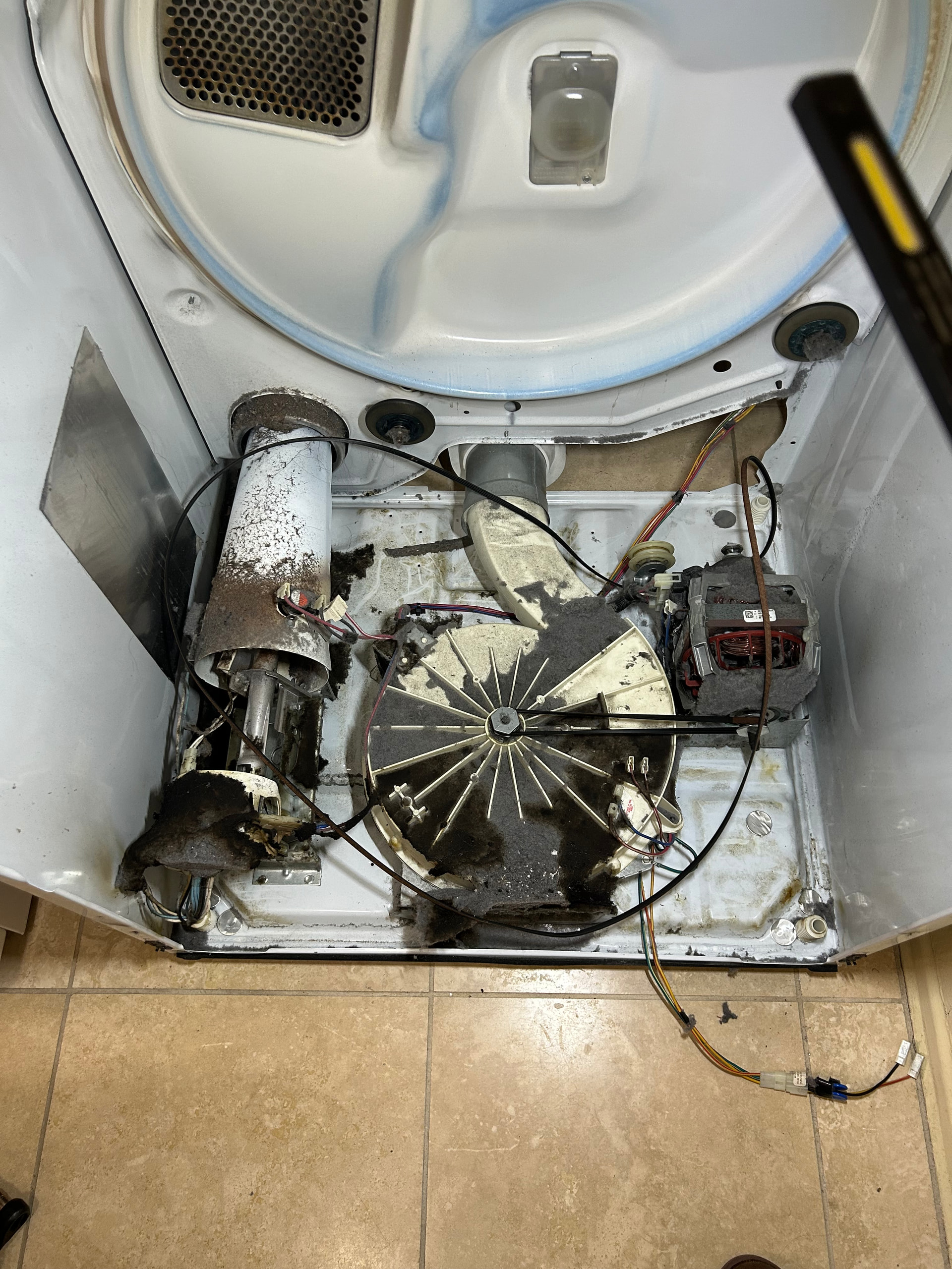

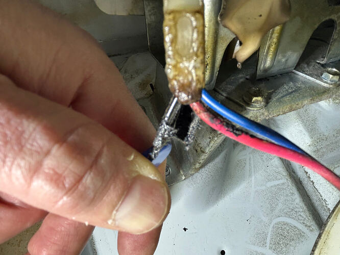

What happens & when: when we were drying clothes we smelled burning coming from the dryer, checked and cleaned the lint screen which was fine. Tried her again and she kept smelling so I shut her down and found a video on how to disassemble the dryer. When I got it apart I found the reason she was full of lint and looked like some it had started to flash fire. I cleaned it all out and found some wires and one connector that didn’t look great but not bad, some melting and discoloration I think I can see copper in one tiny area. I put the dryer back together and before I tried it checked the vent in the wall going to the roof. We moved into a rental not long ago - well I think I found the culprit the lint trap in the wall and all the way to the upwards portion of the vent was compacted full of lint about one nylon grocery bag worth of lint. I cleaned that out. Then I tried the dryer and it seems to be running fine so I would like to know if it’s worth fixing the wires and putting new rollers, belts, and an idler in to give it a few more years of life. When I ran it for about 10-15 minutes on medium heat after running it on air dry only it ran great, the burning smell did not go away but it was not getting worse and was generally much better after the deep clean.

This being worth repairing or not would really be a preference based answer with variables that can sway an individuals preference. It looks like the rollers come in a kit, but the belt and idler pulley would need to be purchased separately since the ones in the kit will not fit this model. The wires themselves would be another variable since this can be a question of replacing the entire harness, field repairing the harness as it is, and so on. Here are links to the parts for reference.
Main harness- W10393458 Dryer Wire Harness | Genuine Whirlpool OEM In Stock

all things being considered this is an older and in my estimation probably a fairly well built appliance, could be worth saving.

The biggest concern I can think of is the potential of a wire grounding out. I have seen mixed results after conducting a repair like this. Since it is operating, it identifies that the controls are operating properly at this time, along with the other components that were not damaged based on visual inspection. However, this does not say that it may have a weak link that could cause further issues down the line. This is where the mixed results come in. I have seen some go through extensive repairs and last a long while, and others go through similar to find something was weakened enough to work for a little while.
Thank you for the information. Given that it works now would you install new rollers, idler and a belt and give it a shot
If it were my dryer in my home, I would replace the rollers, pulley, and belt. However, I would likely also buffer the wires with a high heat insulation so that they would have a minimal chance of grounding out.

I’ve got automotive grade wire tape, will give it a shot.
