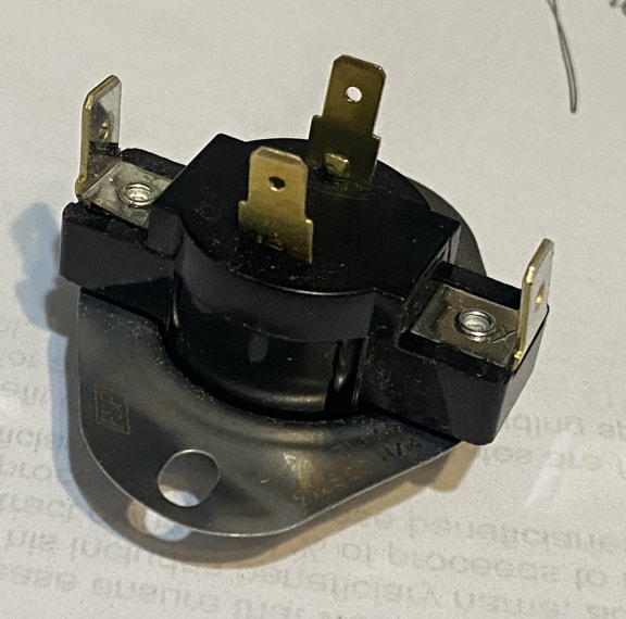

I am replacing a Cycling Thermostat on my dryer and the part I was shipped has what looks like 4 wire connections when the original only had two. The new one has two brass leads near the center and then two silver leads spread apart. If I had to guess, I’m thinking I should connect the two brass leads to the wires available since that is similar to the original. I’m just confused as to why there is 4 versus 2. I’m also assuming there is not a polarity issue where I need to make sure which wire goes to which lead.
It will be a few days before I can do this because the original part received looked damaged from shipping (Fed-Ex).
Thanks, Mitch
Brand: Whirlpool
Model Number: WET3300SQ0
Main Symptom: No heat.
The first picture is of the high limit, but not the cycling thermostat as pictured in the second photo. Here is the part number for the cycling thermostat. It is on the blower housing.https://www.appliancepartspros.com/whirlpool-thermostat-internal-bias-wp3387134-ap6008270.html. There is no polarity for either thermostat. The high limit that mounts on the side of the heater housing is 279769 Thermal Cut-Off Kit | Genuine Whirlpool OEM In Stock. This is the one that would stop it from heating if there is no continuity.

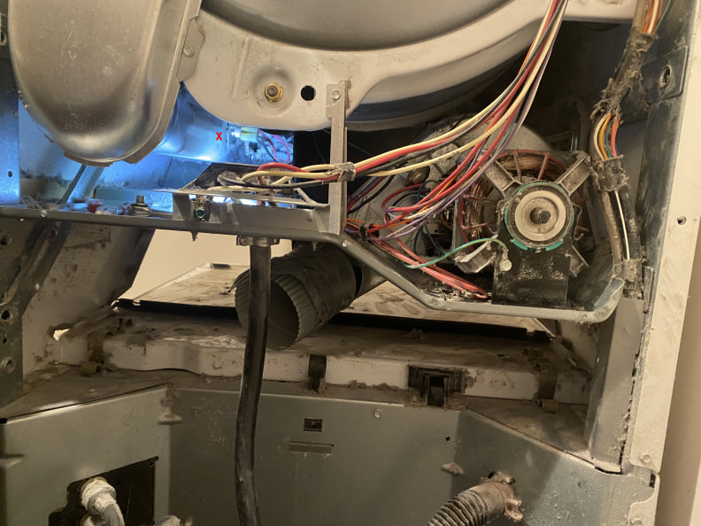

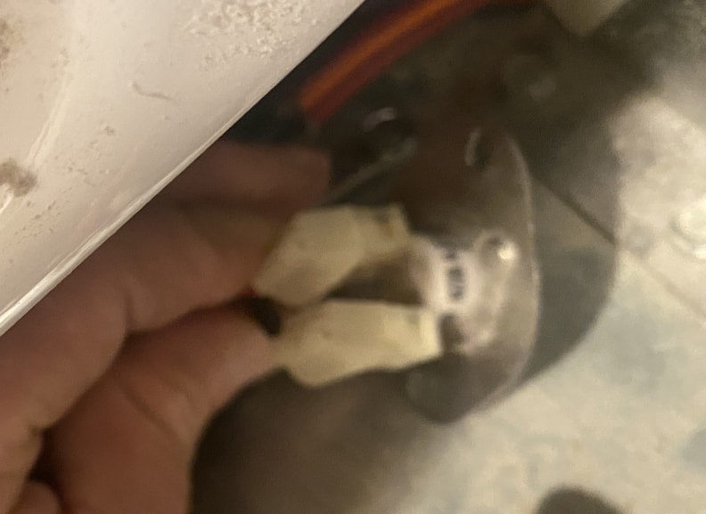

I’m glad I asked. I’ve attached another picture. Where you see a red X there are three sets of two wire connections. Is the cycling thermostat one of these or am I not looking in the right area. I sure wish I had the dryer in the video because it was really simply located.
I’ve looked at the drawing but am still having a hard time spotting it. I know it’s number 42 in the parts picture.
Thanks a bunch, Mitch
Find the blower wheel and housing, this is where the lint screen goes. It is located on the inside of the blower housing, close to where the external vent is that take the air outside. Is this image the back side of the dryer?
Yes, the picture is taken from the back of the dryer.
the blower is typically in front.

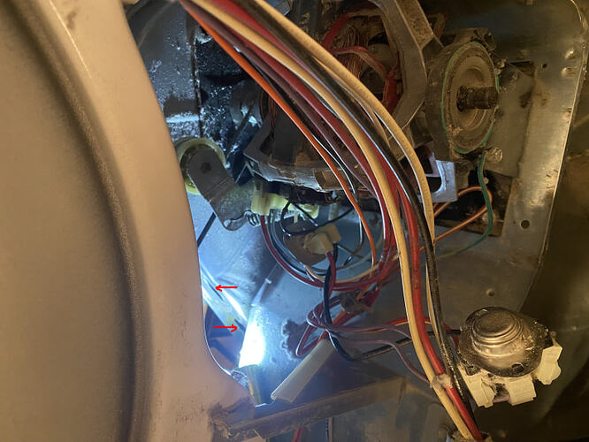

Thank you David. I found it deep in the belly of the beast. I’ve attached a picture showing two red arrows. The lower arrow is where it was located. Directly under the other part you mentioned was the wrong one and behind a brown plastic cover which I removed from the front of the dryer with one screw.
Now once I receive the part in the mail, I will give it a try.

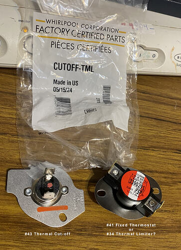

I received my (43) Thermal Cut-off and I can easily see where it goes. However, there is another part included in the package (See pic attached) that I’m not certain about. Is that (41) Fixed Thermostat or is it (34) Thermal-Limiter?
Thank you much, Mitch
The other thermostat should go right next to the thermal cut-off, it is the thermal limiter. both should go on the heating element metal housing.
Dave, look at the attached. My parts page is calling the (34) Thermal Limiter next to the (42) Thermostat Internal Bias. I thought (42) was the cycling thermostat. At least that’s where I put mine.
The part next to the (43) Thermal Cut-off is called the (41) Fixed Thermostat.
Hoping this is it.
Thanks, Mitch
As a tech, I would call a fixed thermostat, the cycling thermostat, the two parts you got together, go side by side just like on the diagram. You did correctly
