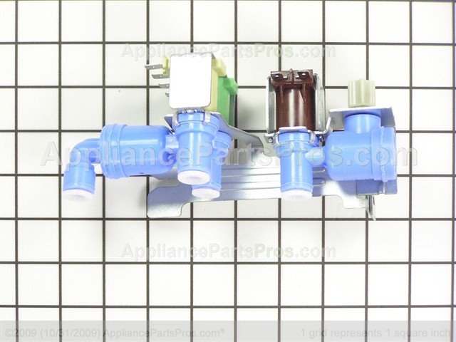

My fridge’s water dispenser is really loud now. I’m guessing the motor on the water dispenser is going out?

There is no motor. There are three solenoid water valves that control the water pressure that your city pipes to your house.
The valves might be going bad or rubbing on something or maybe the assembly is loose and vibrating. You’ll need to take a look. There are three solenoids on this assembly.
Thanks @ThatGuy. Will those valves be towards the back or can I access them through the water/ice assembly area (front)?
