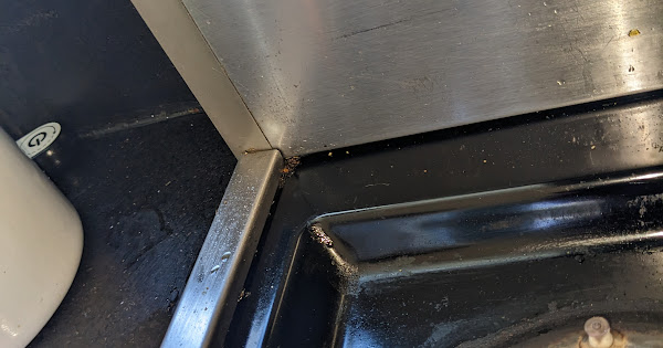

The modules should be under the cooktop unless they are just under a second access panel under the cooktop. Could you provide a picture of what you are seeing?
Sorry it’s grungy under there. But that is the left trim piece that, along with one on the right, is preventing the top from lifting up

It looks like the burner heads are still on the cooktop. They slide down into the orifice holders and would need to be removed so that the cooktop panel can be moved.
The burner heads lift off, and can be unplugged. That’s no problem. It’s the side trim pieces that overlap the edge of the burner top and keep it pinned down.
Google Photos
The last option I can see working would be sliding the range out enough to just remove one side panel. This should allow the cooktop to be angled out.
