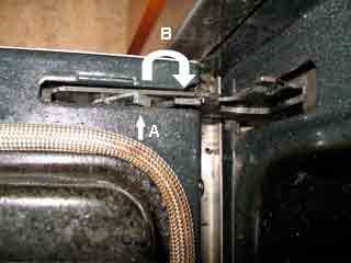

My Viking gas oven door will not close. Does anyone know of a way I can fix myself without calling a repair guy?

Check the door hinges for any damages.

Open the door completely and move the actuator on the door hinge until it locks up. Grabbing the door from both sides, pull it up to release hinges.

If you can take pictures of the hinges and post them it might help.
Please advise how to do send photos. I don’t see a way to embed images into the post. I have some to send at low resolution.
Post it as an attachment.

You have to move the lever “A” to position “B” to lock the hinge.
Grab the door with both hands and lift it up to release the door hinges.
I tried to do that but the levers wouldn’t move into that position. They probably will when the repair person arrives to do the job, and I’ll be there to watch and learn. Thanks for making the effort to help me out with this.

Looking at the previous pictures, most likely the door has to be disassembled in order to replace the gasket.

My viking looks identical to the one pictured here, but am still need help. When oven door is fully open, it is difficult to get hold of the levers to pull them up as suggested. But when pulling up on the door when it is opened 20 degrees, the left lever pops up by itself, but the right does not. In fact the oven door feels like it will come off on the right side without even locking the lever. What’s happening. Thanks,

Thanks. I got that far (door off)–now how do I remove the old hinges from the stove?
