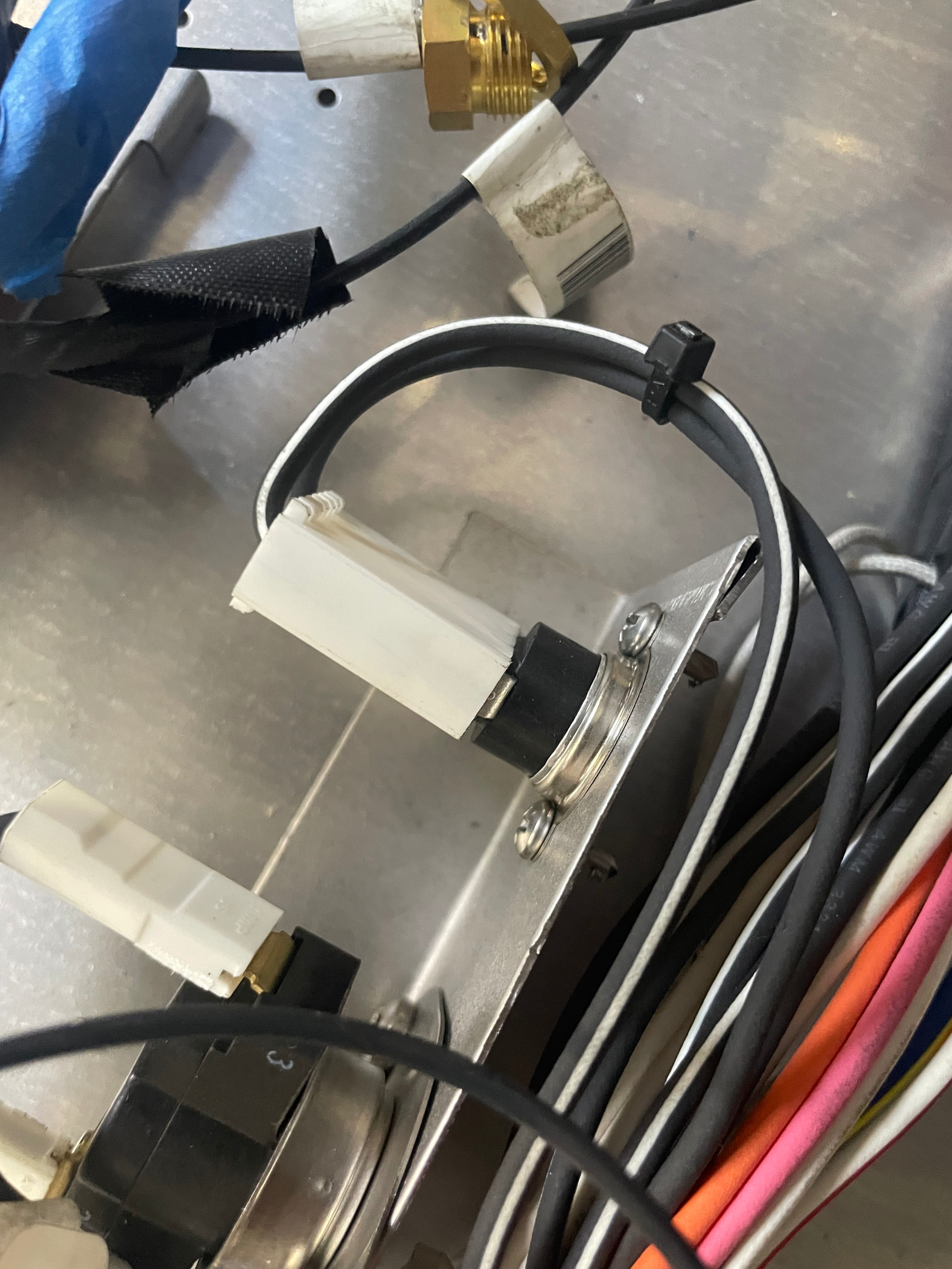

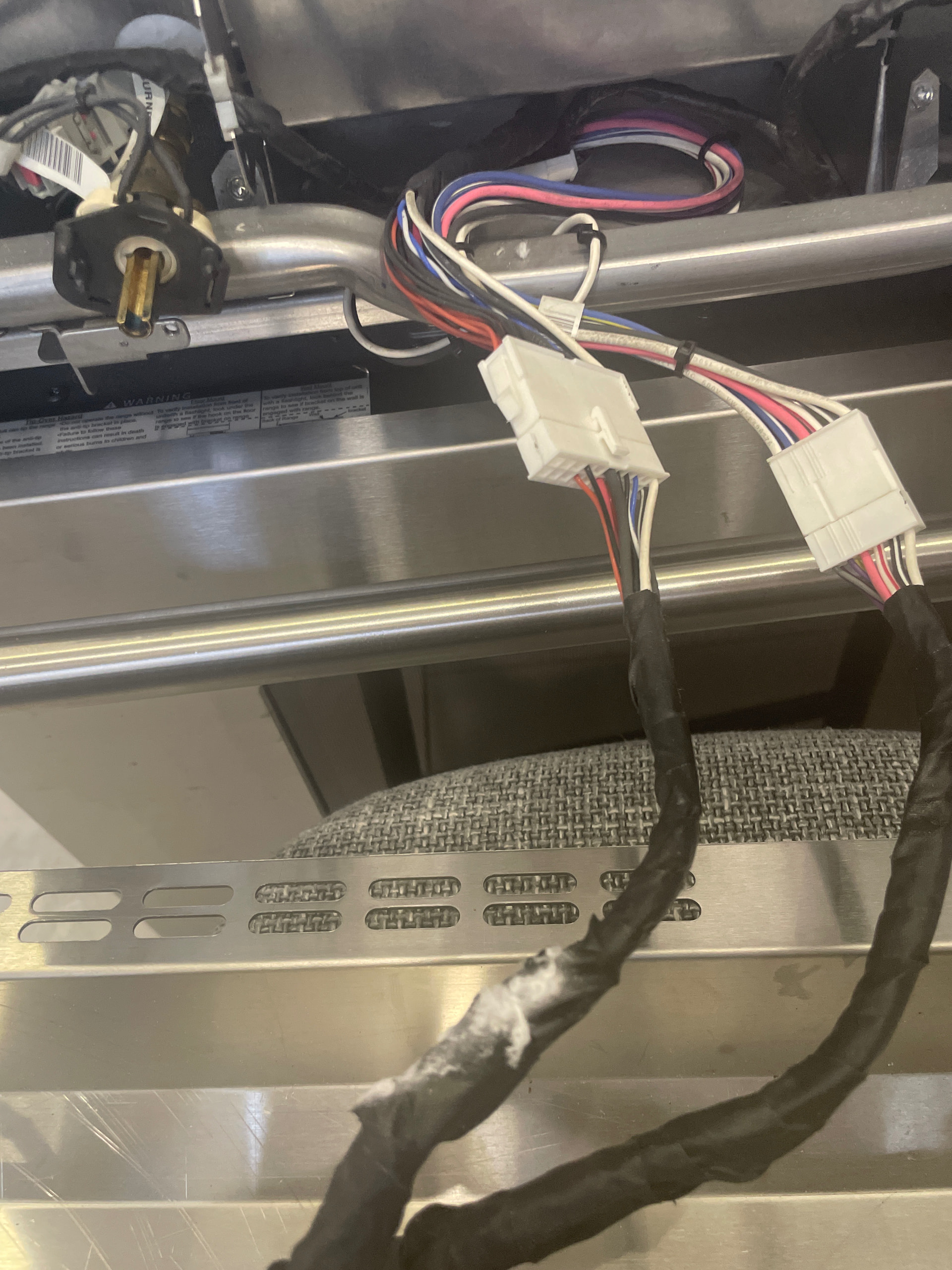

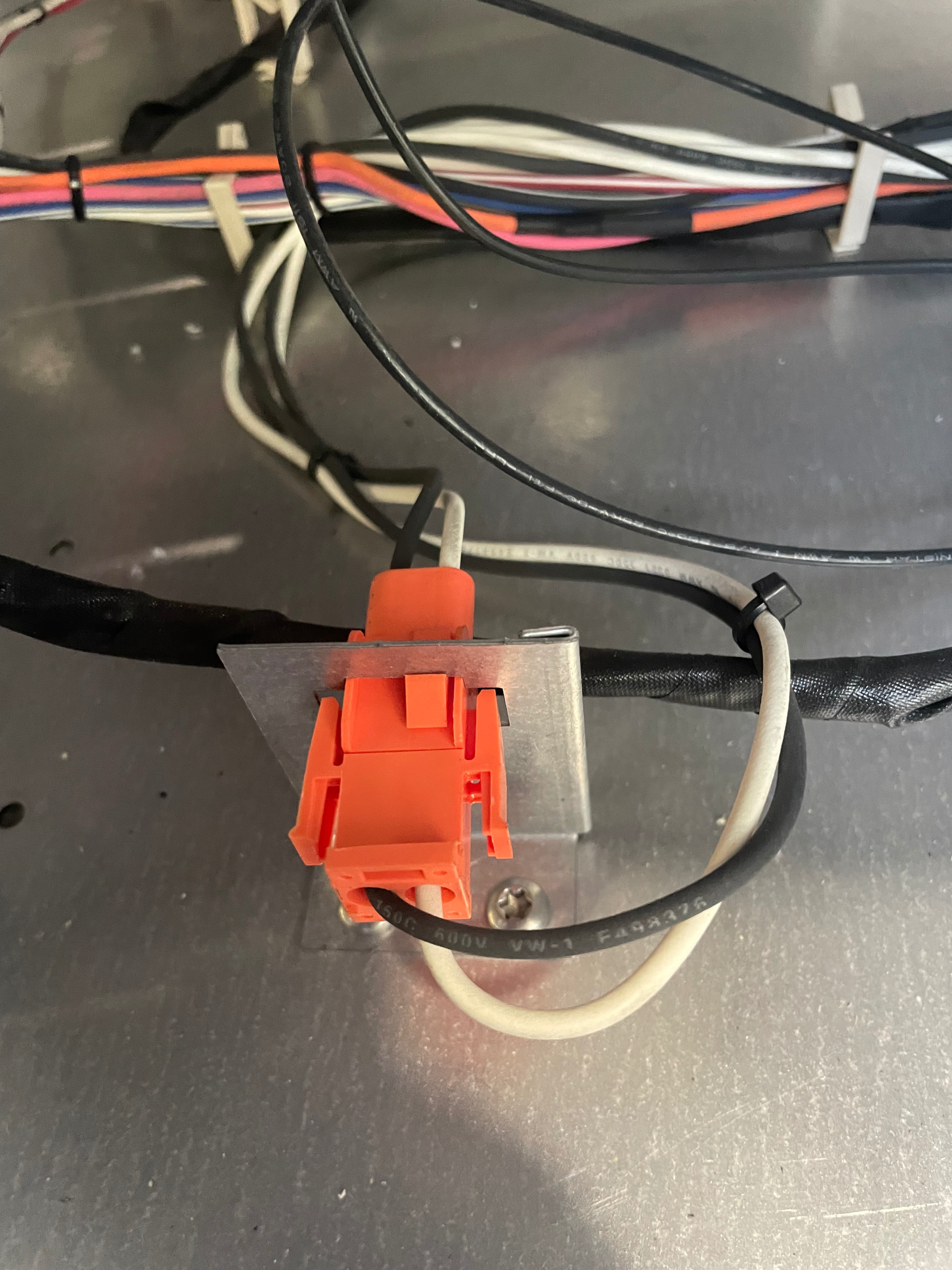

The wires leading from the control module under the cooktop to the DSI module behind the oven would need to be inspected for any indications of damage or bare spots. With the power and gas supply turned off, the grates, burner heads, and knobs would need to be removed. From there, the knob bezels would be removed to allow the front panel to lift up and out off of the front of the range. The cooktop panels would then need to be removed. This should give a good view of the control on the left side. Do the wires look like they are damaged at all? Also, does the control module or the DSI module look like there might be any indicators of damage such as black spots?
ok, I’ll do everything you’ve asked and get back to you with photos and comments, thanks
There should be a control module (part number 062885-501) under the cooktop that would look similar to what is in this attached image. Does there appear to be any indications of damage or heat spots on this control? It does not look like there is any signs of wire damage.

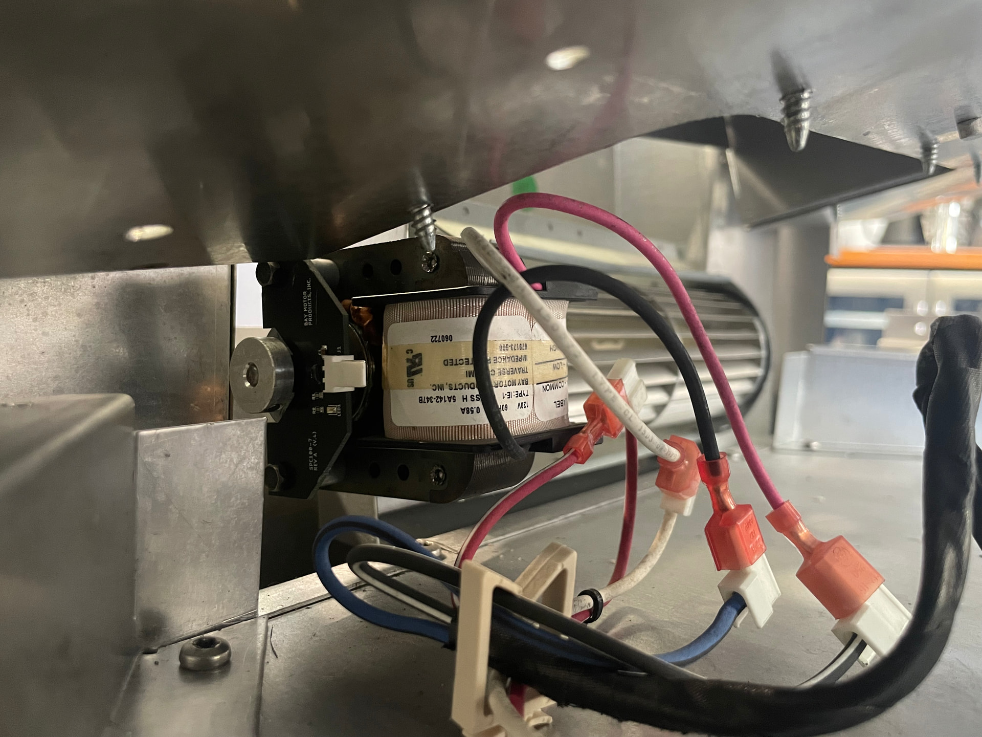

Hello, change everything and the problem continues, don’t know what to do
When it shuts off, are you able to immediately turn it back on or does it need to cool down first? Also, if you turn the oven knob a little bit, does it tun the oven back on without having to move it to the off position?
When I turn it on, it stays on for a few minutes and then turns off; when I turn it on again, it turns off even faster.
Are you able to turn it back on immediately? Also, what do the flames on the bake burner look like when it is in operation? The bottom panel inside of the oven can be removed to check during operation.
You can turn it back on as soon as it goes out.
I removed the bottom panel, and the flames light up normally, but they go out after a few minutes. I’ll make a video so you can see it.
