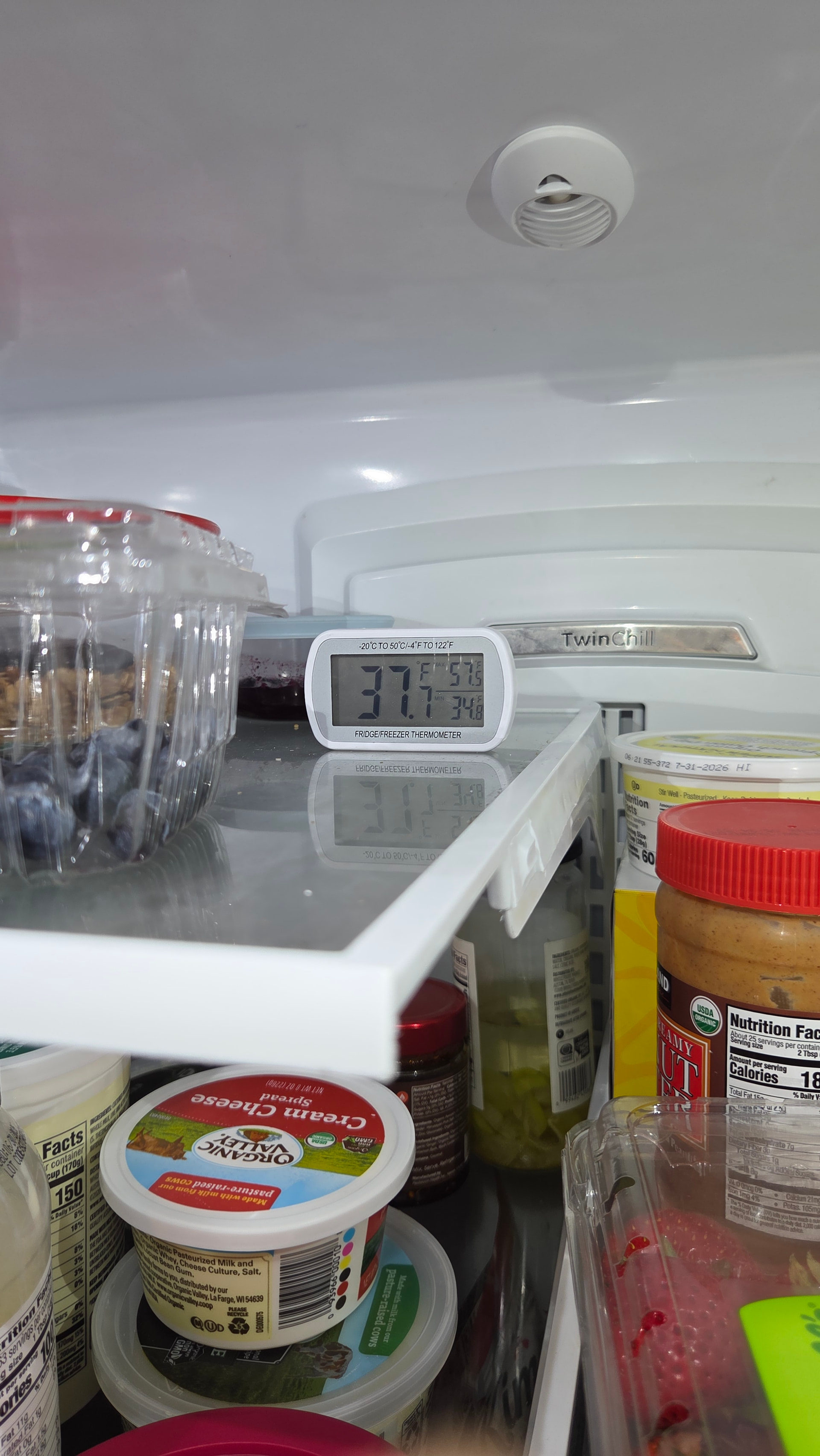

The top shelf of my GE refrigerator gets up to 53 degrees while other shelves remain cold
Brand:GE
Model Number:GFE28GSKBSS
**Main Symptom:**top shelf gets up to 53 degrees
What happens & when:top shelf temperature fluctuates between 35 and 50 degrees (up to 55 degrees)
Error Code (if any): none
Parts or tests already tried: replaced temperature sensor (WR55X10025) in ceiling of refrigerator

  1. The top shelf being warm is intermittent, but occurs once or twice a day. The thermometer in the pictures show current, max and min temperatures. I was resetting the max/min daily so I could see how often the issue occurred. Seemed to only go above 50 degrees once or twice a day. I haven’t seen a correlation between the doors being opened and the temp going up to 50+ degrees.
    3 days ago, the current, max, min temps were 39, 50, 35. The latest picture I am attaching shows 37, 57, 34 (no reset in between). The fridge is set at 37 degrees.
  2. I didn’t hear or feel a fan blowing earlier today but I did just now when I checked.
  3. I don’t have access to the fridge evaporator now. I can tell you that I did replace the fridge evaporator fan a few years ago. The symptoms then were warm temp with freezing of foods in the bottom climate zone fridge drawer. When I put the thermometer in the climate zone drawer now, the temp range is 34-37 consistently.

Right now it is 44 degrees on the top shelf and no fan is running.
Also, it was 41 degrees last night before we went to bed and this morning the max temp registered by the thermometer was 55 degrees without opening the doors. Current temp was 37 degrees when I checked this morning.
It is able to cool most of the time, but sporadically it stops cooling.
30 minutes later, it is 52 degrees and no fan is running.
It may be a faulty temperature sensor. I have included a link to the part and if you scroll down there is a video of how to install it. WR55X10025 Refrigerator Temperature Sensor | Genuine Ge OEM In Stock
I already replaced the temperature sensor in the ceiling of the fresh food section, figuring that one is closest to my problem.
